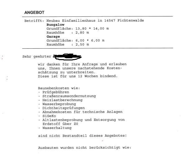

I find it difficult to tell whether being proactive means helpful or if it just comes across as annoying/pushy.

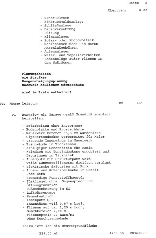

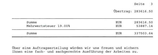

I have now received a first quote from our preferred company. However, I find it very rough and imprecise. What do you think?
Offer letter: New single-family house with dimensions 13.80 × 14.00 m (45.3 × 45.9 ft) and additional building costs.
Document page with cost list and construction measures for bungalow with garage.
Page 3 of a document showing total sum, VAT 19.0%, and carryover 283,616.50 EUR.
Mycraft14 Jul 2020 14:27
Yes, it is simply a standard offer for a very basic, cost-saving configuration. Without any additional features, since it is the first one and they do not want to reveal too much right away.

Mycraft schrieb:
Yes, it’s basically a standard offer for a very basic budget specification. Without any additional features, since it’s the first one, and they don’t want to reveal everything right away.
So it’s not unusual and doesn’t reflect on the company itself? If I follow that model and exclude the double garage, I end up at about 2,000 €/m2 (around $186/sq ft) of living space and roughly €280,000. That leaves about €50,000 - €70,000 available for a photovoltaic system and other extras.
