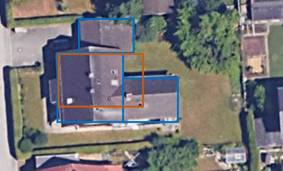

Before I reply to you (probably not tonight anymore), you could start by drawing the existing structure on the plot plan and comment on how the overlap between the old and new house footprints would look.

Attached is a sketch:
Blue represents the current existing building.
Garage at the top 6x8 meters (20x26 feet) – probably not basemented
Main house (I believe 9x9 or 10x10 meters) (30x30 or 33x33 feet) – shallow basement, condition reasonably appropriate for its age.
Extension on the east, right side of the plan (8x5 meters) (26x16 feet) – the basement here is about 40cm (16 inches) deeper, but there was some kind of mistake made. It is damp and moldy. The basement ceiling/ground floor floor is cold.
The new building 7x11 meters (23x36 feet) would be almost aligned at the top/left of the plan with the existing building.
This is due to a) the building line on the left side of the plan and we want to build as far north as possible to have more garden space on the south side.
The building limit to the north is set at 6m (20 feet) = garage width.
Along the entire length of the south facade (18m) (59 feet), I would estimate a height difference of 0.5-0.8m (20-31 inches), sloping down towards the street.
Only in the garden on the west side, between the street and the building, is there an additional height difference of about 0.5-1m (20-39 inches).
At the street, the garden is about 0.5m (20 inches) stepped down with a small concrete wall / L-shaped blocks.
This means the driveway to the garage has a height difference of over 1m (39 inches).
Luftaufnahme eines Hauses mit Grundriss- und Grundstücksüberlagerungen

a) The building line on the left side dictates this.
Is it really a building line? Does the neighbor to the lower side have a different one? The house is actually closer to the street.
