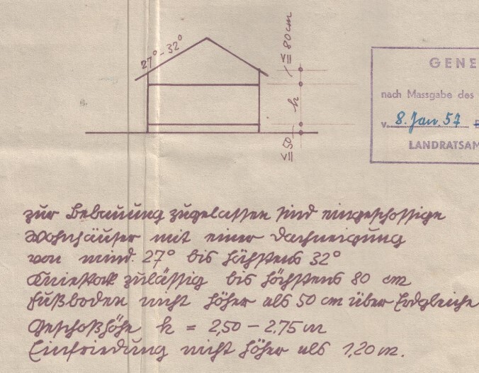

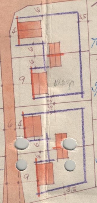

1 Jan 2025 16:36
Here are two screenshots of the development plan.
Indeed, that is the building line, and it is also true that the neighbor’s house is set back, positioned closer to the street.
I mentioned the one-third residential basement to two-thirds utility basement not to create a mixed calculation, but to estimate the question: "Can basement area be shifted above ground level?"
This question would certainly be answered differently if it were a 100% utility basement compared to a 100% residential basement. Right?
The plot is indeed large enough. And the development plan allows for sufficient buildable area.
My main concern was how this would work if there is already a hole, since the existing basement will have to be removed anyway.
To what extent a house without a basement is cheaper or more expensive than a house with a basement, assuming the floor areas are identical in both cases.
Hand-drawn floor plan of a house with room layout and stairs
Technical sketch of a house with pitched roof, dimensions, and stamp.
nordanney
1 Jan 2025 16:54
You have already received this answer many times here. Asking repeatedly won’t change anything.
