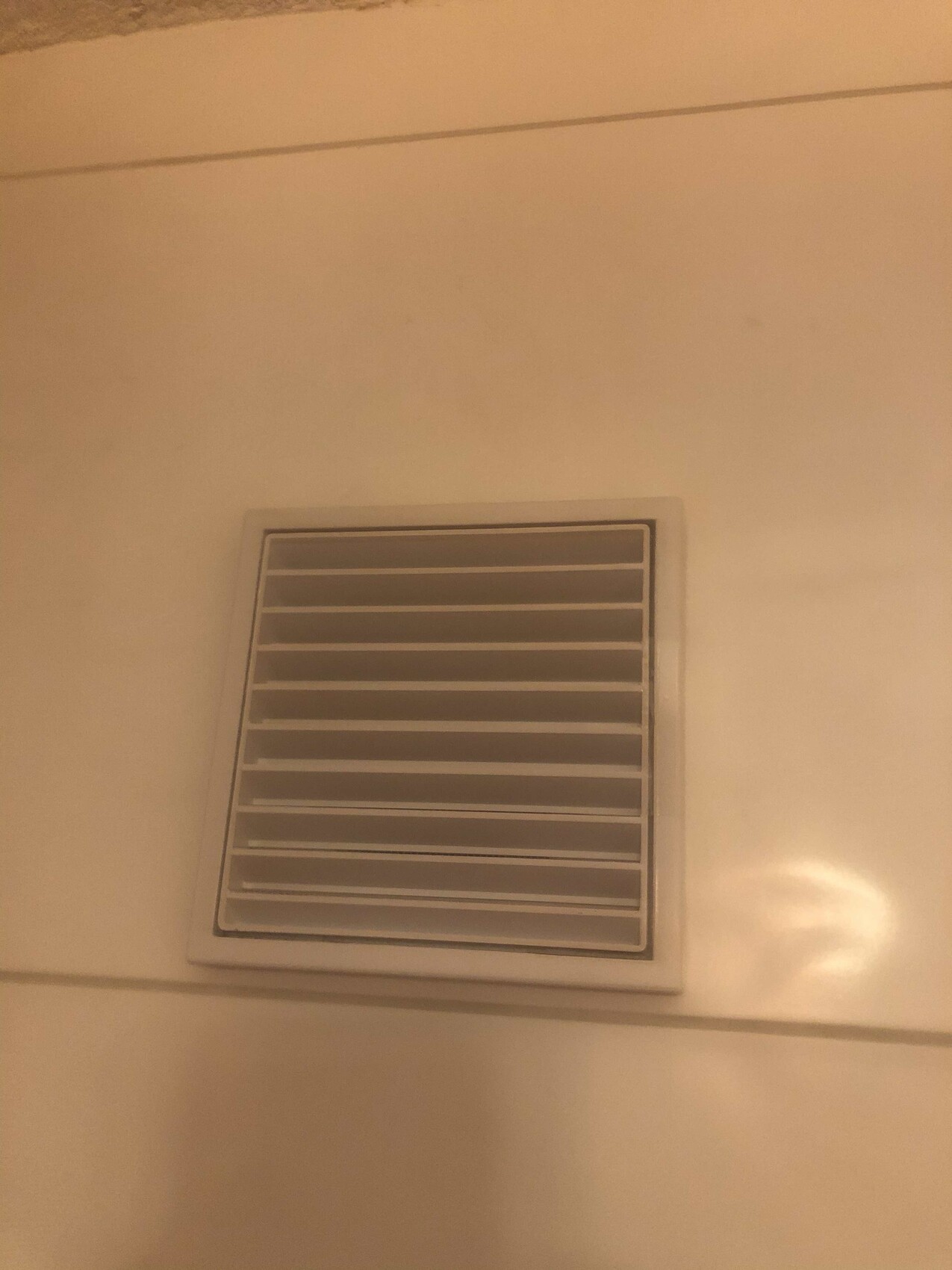

I have just moved into a new apartment on the third floor. The guest toilet is fairly simple and located inside the building.
There is an exhaust fan that can be manually operated with a timer switch (up to 15 minutes).
Above the toilet, there is a vent in the wall (100mm (4 inches) pipe with a simple square grille). Behind it is a fan controlled by the timer switch.
The two apartments below also have a guest toilet in the same spot. Apparently, the neighbors use it quite often for their heavier business... and since the exhaust pipe runs vertically throughout the entire building, unpleasant odors from the neighbors are rising up to our apartment... No matter when I use the guest toilet, it smells very strong.
My question is: Is it possible to install a valve instead of the louvered cover on my 100mm (4 inches) pipe in the wall so that air can only be drawn outwards (into the exhaust pipe) and not flow from the pipe back into my apartment?

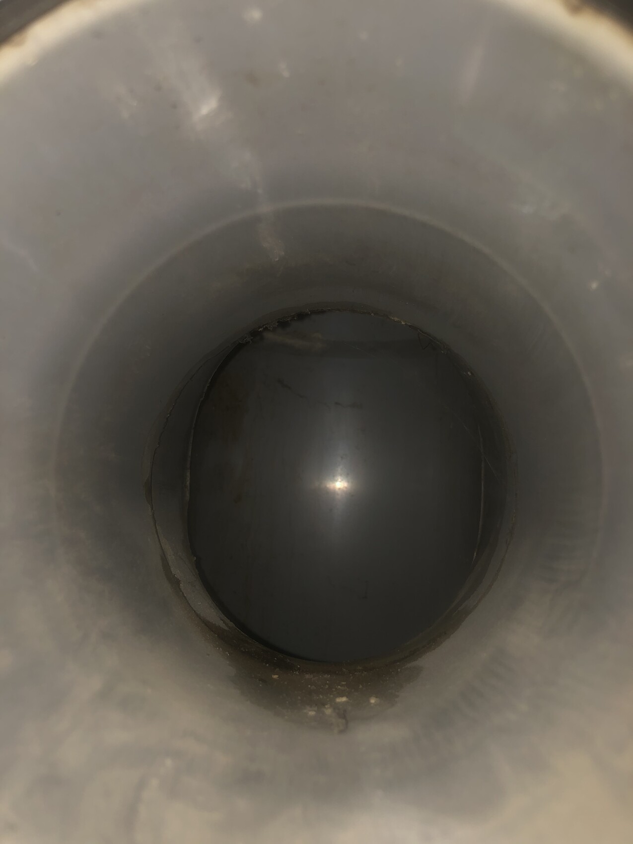

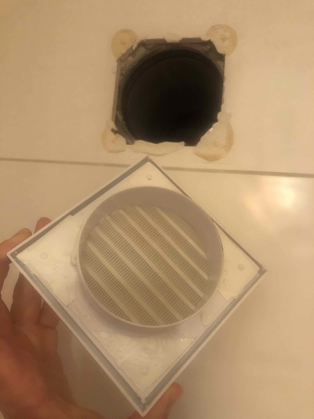

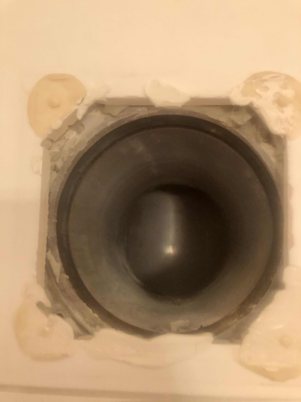

Bau-Chris-BW10 Oct 2020 10:10Scout schrieb:
You need a bathroom fan backdraft damper for 100 mm (4 inches), which goes inside the pipe. This way, the air can only flow in one direction. I removed the cover (see photos) and found the backdraft damper online. THANK YOU!
Can you simply install such a damper inside the grey pipe?
The fan is located behind the backdraft damper – in photo 4 you can see the riser pipe but not the fan. Does that cause any issues? Does the fan have enough suction to open it?
Sorry for my silly questions – I really have no idea
