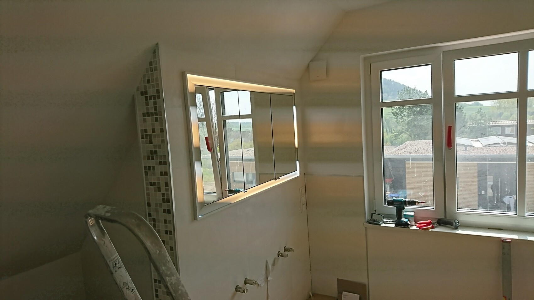

We have a 120cm (47 inch) Keramag Icon paired with a 120cm (47 inch) built-in mirror cabinet. Using a washbasin and mirror of different widths would have looked like something we wanted but couldn’t achieve.
Our cabinet is from Laguna and has a fixed frame. It is installed like a typical wall cabinet on rails inside the niche, but because it has a wooden frame construction and the niche was very precisely made, I attached it with four pan-head screws through the side panels and covered the screw heads with matching caps.
The washbasin is not yet installed in the picture, and the stripes you see are reflections from the LED lighting.
matte1987 schrieb:
Great, thanks!
Since we are installing the same washbasin:
Would it be possible for you to please upload a photo once the bathroom is finished, or at least when the washbasin is installed? I’ll try to remember tonight. The bathroom has been in use for 2 weeks.
