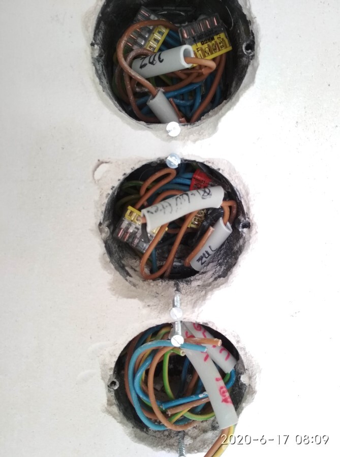

Our electrical installation is nearly complete, and I am not sure if all my requests were implemented by the electrician as discussed. He had told me that all light switches would be installed with deep flush-mounted boxes and as push-buttons (at least those that I marked accordingly), so that I can later connect a wireless actuator behind them.
I have now taken a closer look at the switches and found the following types installed:
As you can see, several types of light switches were installed.
My basic question: Is it possible to install a wireless actuator behind each of these switches without, for example, an off switch position disabling the wireless control?
before questions about the electrical installation come up: we have deliberately chosen a conventional electrical system.
Now to my question:
- Merten MEG3115-0000 as a series switch insert (switch function: 2 circuits), rocker push-button
- Merten MEG3116-0000 as on/off changeover switch insert (switch function: 2-way), switch
- Merten MEG3150-0000 as push-button insert (switch function: 1-way), push-button
