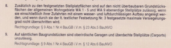

I have a question. My plot is designated as WA 2.
In the development plan, the following is stated:
Excerpt of a building regulation text regarding parking spaces and non-buildable areas
Am I allowed to build a carport or not? If not, what am I allowed to build instead?
Does this have to be within the building plot?
A house without a carport or garage somehow seems not quite practical.
Hopefully, someone can help.
Text excerpt about parking spaces, access, and building regulation restrictions

Probably not – have you already bought it??

This has nothing to do with a building permit / planning permission – if it is not allowed in the area, then it simply isn’t allowed. Of course, you can apply for a building permit / planning permission, and usually the neighbors will be consulted – but I can already guess their response.
Maybe it’s a car-free zone? We have something strange like that here too – where you’re not even allowed to drive in with a car.
Koempy6 Aug 2015 10:13
Point 9 clearly states that a carport and garage are not allowed.
Point 8 states that additional parking spaces can be created if they allow rainwater to pass through. Basically, something like grass pavers with holes or similar.
