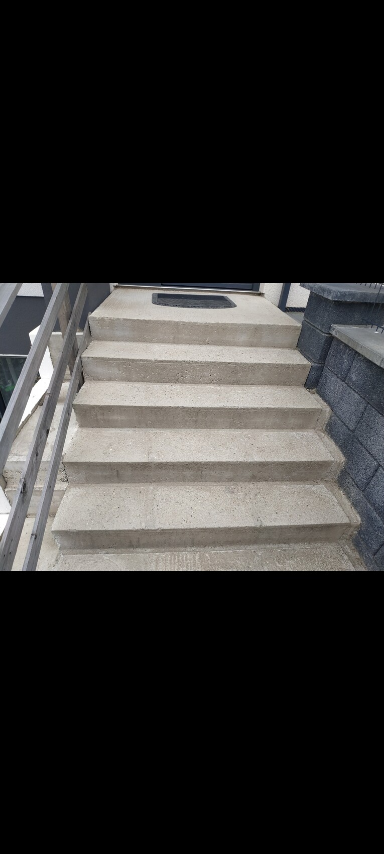

Benutzer 100121 Jul 2022 00:25We have a house on a slope with two entrances.
The upper entrance features a concrete staircase clad with granite.
Between the house and the stairs, we left a dimpled membrane as a separation layer. It has been problem-free for 5 years.
Steel mesh reinforcement is embedded in the concrete.
Here, I would only change the color, making it less dark.

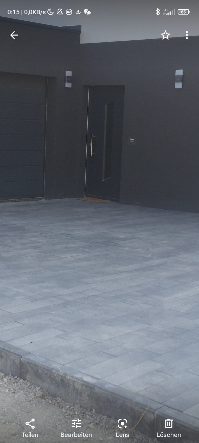

In the granny flat, the area is paved directly, with drainage located beneath the stones, and there is a birch gutter by the garage. So far, no problems with water.
