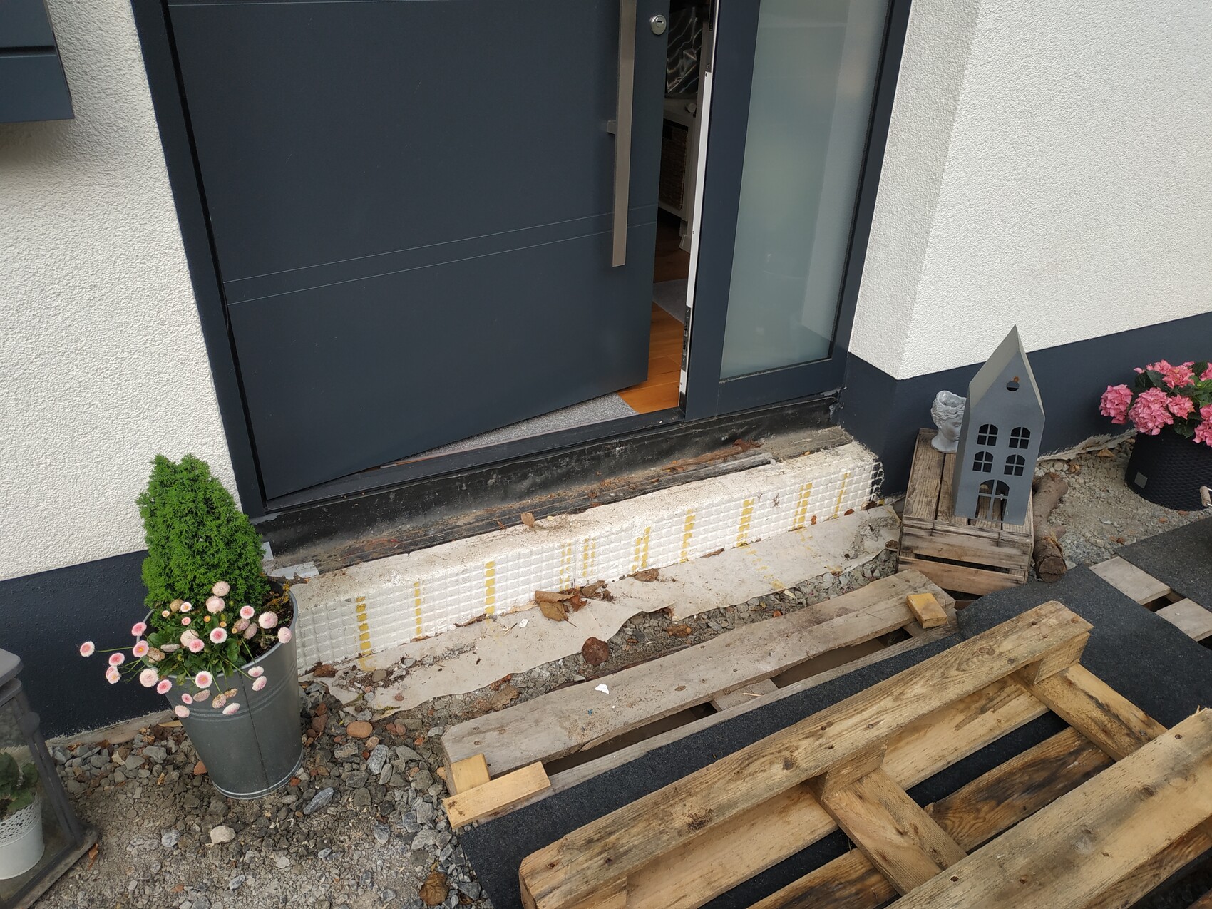

We are planning to pour concrete for our entrance platform, which will be covered either with WPC decking boards or natural stone slabs. The platform will be wider than the door opening.
In the picture, you can see the current situation. A black waterproofing strip has already been installed by the window company, and in front of it, the white perimeter insulation of the basement is visible. We have now applied a self-adhesive bitumen membrane here (not yet visible in the photo).
Is there anything we need to consider before pouring the concrete? Should XPS boards be applied to the render?
