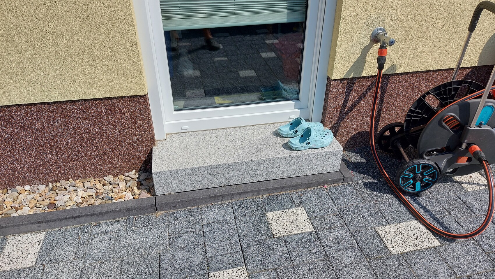

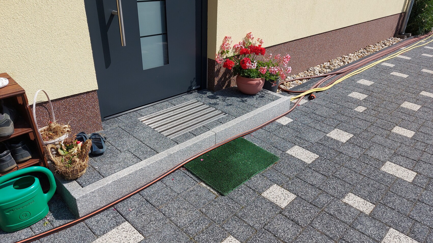

Entrance platform with granite edges and paving stones,
granite stones as platforms at all “doors.”
