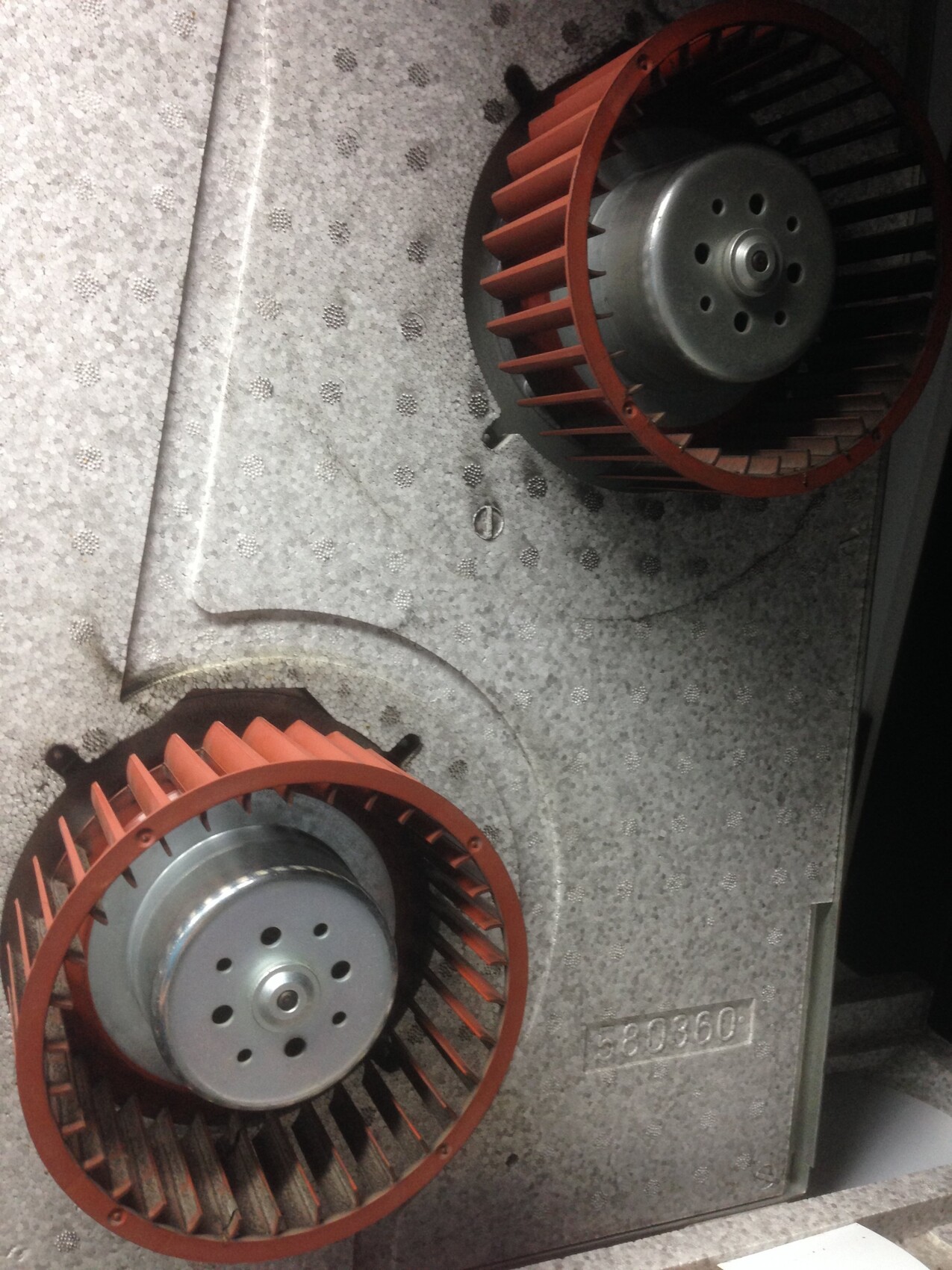

As for the original poster and others, Alex85 has already said everything. No filters, no smooth ducts. So errors occurred during planning, installation, and operation of the system. It’s no wonder that cleaning is necessary.
P.S.
This is how the impeller wheels of my system look after three years of continuous operation. In my opinion, this is absolutely harmless. Bottom = exhaust air, top = supply air
Two round fan wheels with orange blades inside a gray metal housing.
