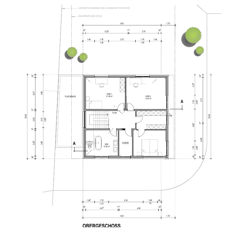

I find the ground floor extension unattractive. You will probably use the balcony rarely, but it will add costs during construction and maintenance. I also don’t like the toilet without a window located right in the middle. The kitchen layout is not very ergonomic. Consider reducing the size of the ground floor and enlarging the upper floor so that both levels have a similar area. The utility room on the ground floor would then be much smaller, but you could create a laundry room upstairs (where the laundry is done) and also add a walk-in closet. The facade still needs some fine-tuning; so far, I don’t find it very appealing. For the dining table area, I would choose larger windows, especially facing south. Attached is a suggestion on how the layout could be rearranged. Windows are only partially indicated in the sketch.
Grundriss Erdgeschoss: Haus mit Garage links, offener Wohn-/Essbereich, Küche, Eingangsbereich und Garten.
Obergeschoss-Architekturplan mit Flur, Bad, HWR, zwei Kinderzimmern und Treppe.

Würfel* schrieb:
I find the ground floor extension unattractive. You probably won’t use the balcony much anyway, but it will add costs during construction and maintenance. I also don’t like the bathroom placed in the middle without a window. The kitchen layout is not very ergonomic. Consider reducing the size of the ground floor and enlarging the upper floor so that both levels are approximately the same size. The technical room on the ground floor would then be significantly smaller, but you could add a utility room upstairs (where the laundry is done) and even include a walk-in closet. The facade should also be refined, as I don’t find it particularly appealing so far. For the dining area, I would suggest larger windows, especially facing south. Attached is a suggestion for a revised layout. Windows are only partially indicated.
[ATTACH alt="Lemmy-EG.jpg"]49236[/ATTACH][ATTACH alt="Lemmy-OG.jpg"]49237[/ATTACH]
Very cool
