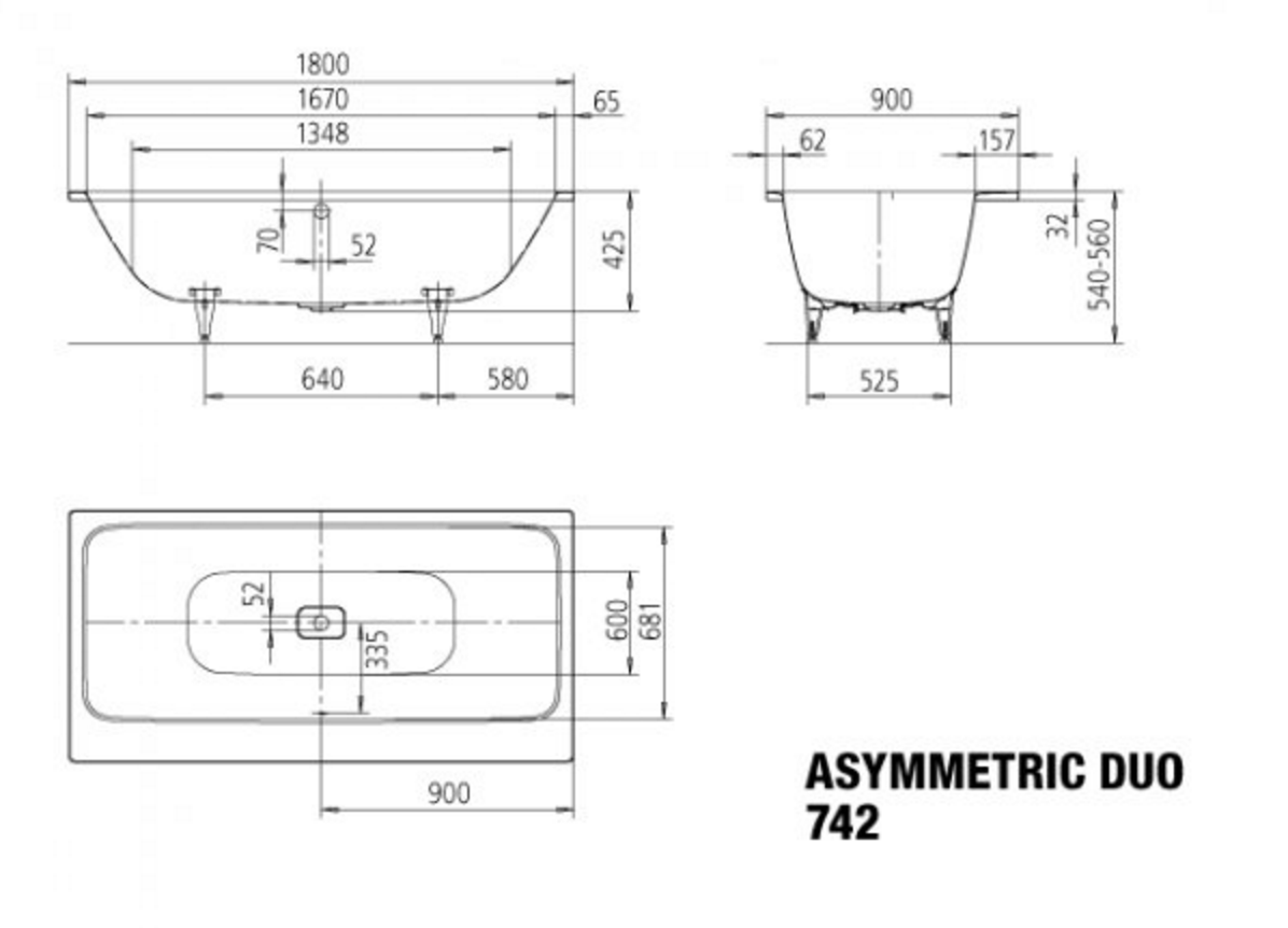

The bathtub should be positioned in front of the window, which is 150 cm (59 inches) wide and 148 cm (58 inches) high, so that the top edge of the bathtub is level with the tiled window reveal. The tile thickness is 12 mm (0.5 inches). So far, so good. But:
The original architect’s plan specified a window sill height of 39 cm (15 inches). During the material selection meeting, we were told this was far too low and advised to go with 60 cm (24 inches). That was agreed on and the window was installed with a sill height of 64.5 cm (25 inches). Currently, the height from the screed to the window sill is 66 cm (26 inches). This will not change after tiling. This is much too high for the bathtub...
Since this was the company’s mistake, we will insist that the window be lowered (a kitchen window is being lowered due to a similar error as well).
However, what is the correct height? I would appreciate suggestions measured as "height from screed to window sill."
The bathtub is a Kaldewei Asymmetric Duo.

The question now is, if we set the parapet height to 58 cm (23 inches), the surface of the tile would be around 59.5 to 60 cm (23.4 to 23.6 inches). That would also apply to the bathtub. Do you think this is okay or would you prefer it lower?
The legs are adjustable and the screed is recessed.
