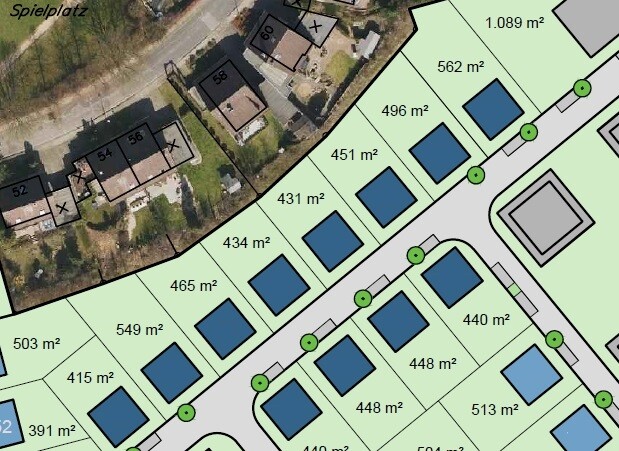

king_200019 Jan 2018 11:47ypg schrieb:
One can hope that the application is not approved. The issue with the 16-meter (52-foot) width was known; in such cases, you save space by skipping a garage and instead prioritize having bright rooms facing the car. That’s my opinion. I don’t know if everyone has noticed, but this is a new development area. Around here in the Ruhr region, plots are very limited, which is why the building lots are so narrow. Even if I replace my garage with a carport, my carport would be located between my house and the neighbor’s garage.
Someone mentioned that it has a townhouse style, and in a way, they’re right.
All plots are 16 meters (52 feet) wide and must have a 3-meter (10-foot) gap to the neighbor, so it’s clear that garages will be placed there.
So you have the choice:
1. Own a garage but have no side windows
2. Have windows (possibly under a carport), but from the window, you see the neighbor’s garage just 3 meters (10 feet) away.
I think people living in rural areas would complain a lot because they aren’t used to this. City dwellers are very happy to get any plot at all.

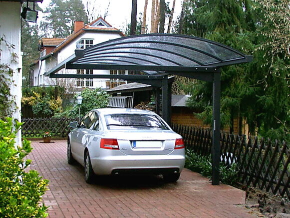

king_200019 Jan 2018 11:48ypg schrieb:
You’re not doing yourself any favors by discussing a design after submitting the building permit / planning permission application.You’re right. I wouldn’t do that again either.
I still wouldn’t give in to this garage madness. Who knows what the future will bring? Maybe cars will soon be banned in cities altogether, or there will be free electric rental cars that you can summon anytime via your phone and that drive to you autonomously.
If I understand correctly, the neighboring garages are then 6 meters (20 feet) away in total. So there is still a chance for light to come in from both sides. It also depends a lot on the overall design.
Just as an example, without judging whether this is the nicest carport of all.
Of course, it’s hard to decide on anything else at this point. I understand that. But these living rooms without windows on the sides are simply a sin, sorry.
