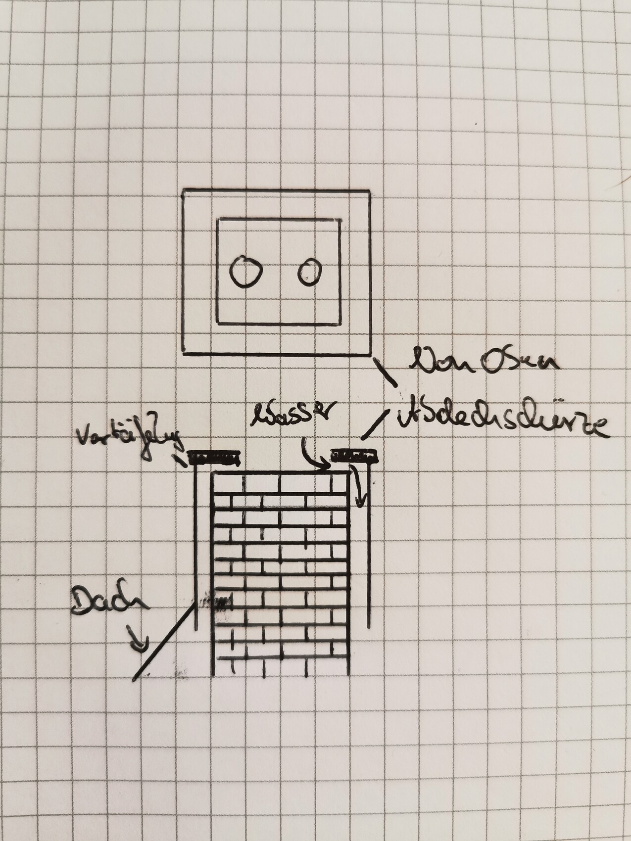

The roofer justifies his €1000 (approximately $1100) quote by saying that the water was kept out by the cover cap. But as a layperson, that doesn’t quite make sense to me when I look at the actual construction condition. I see a loose membrane between the paneling and the chimney wall, and light coming through between the cover flashing and the "chimney end." That’s where the water is also coming in. I will try to illustrate this again with a drawing.

HilfeHilfe5 Jun 2020 05:56Well then, show him that the membrane is lying loose on the masonry and that water is dripping between them.

Well then show him that the membrane is loose on the masonry and water is dripping through there. As I said, I already did. He says that’s how it’s supposed to be, and if the flashing was still covering the chimney, no water would get in.
Before I get really upset with him, I just want to know—is this botched work, or is it actually done like this?
