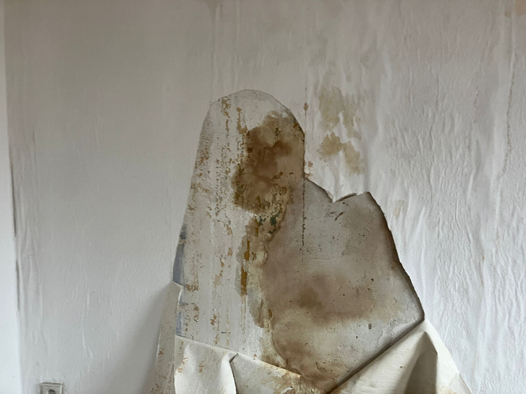

Here is a damp wall. We removed the wallpaper to take a closer look underneath. The house is about 100 years old.

What I notice in the third picture is that the lower row of trapezoidal metal sheets is installed over the upper row. No idea if that’s the cause.
In general, I can only advise not to make improvisations on the roof but to have it done correctly from the start.

The sheets are not seriously overlapped the wrong way?!?

The photo was taken only from below. The overlap is actually correct. The image is misleading here.
It will be difficult to determine where the water is entering. This could now also be due to increased rainfall. Often, the screws are responsible for water infiltration. There are small rubber washers underneath that become brittle over time. Water can then get in there. However, if it happens, it probably wouldn’t be as much as in your case.
Maybe just replace the screws. That would be the simplest and most cost-effective solution for now.
Otherwise, the obviously renewed sealing around the chimney comes to mind as the possible cause. I would check the overlap on the aluminum flashing there. If water hits the chimney during heavy rain, it might accumulate there and be pushed under the red corrugated metal roofing. In any case, that area doesn’t look very good to me.
Did the roofer work on that corner?
Water always finds its way, and the hardest part of dealing with a leaking roof is figuring out where the leak actually is. So you have to look carefully. But, as I said, check the chimney sealing. That is always a weak point.
