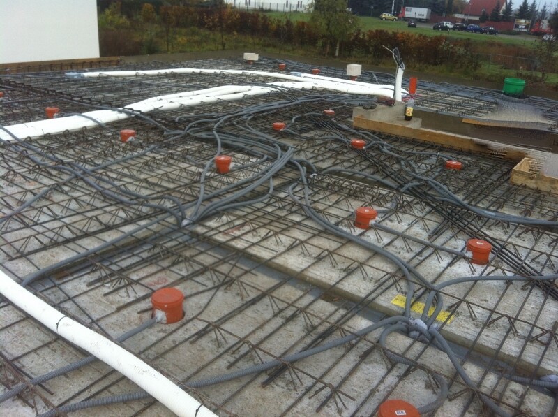

We have just started the groundworks, and I am currently in the middle of planning our ceiling spotlights. These should fully illuminate the living, dining, and kitchen area. We plan to attach KG caps to the precast concrete ceiling and lay the cables directly through conduits before having the concrete poured. We will handle drilling through the precast ceiling ourselves later on.

Your plan is flawed; how do you intend to drill through a precast concrete slab later on?

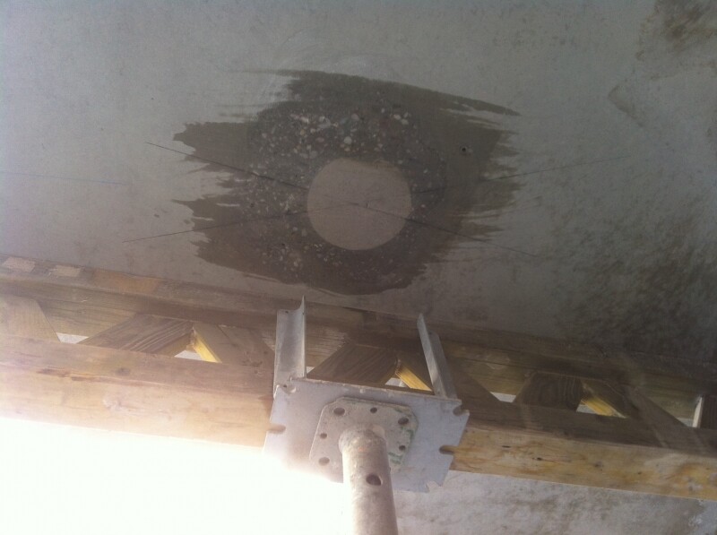

If you are using PVC sewer pipe (KG pipe), you will need one 125mm (5-inch) slip coupling, two end caps, and one Fermacell board. A hole is drilled (chiseled) in the precast concrete slab, then formwork is installed from below, the box is positioned, and fixed from underneath through the formwork with a screw.
The precast concrete slab is great for drilling; you don't need to go through major work like chipping or using Fermacell boards.
I would also try to minimize damage to the smooth ceiling surface... meaning definitely avoid chipping out 125mm (5-inch) holes and then filling them again... the smaller the hole, the better.
Simply drill a small pilot hole where the electrical box will be, and later use a suitable core drill at the final position to make the hole.
But as has often been said, it’s best to invest a few extra dollars for factory-made concrete electrical boxes... that would be the best approach.
