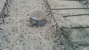

You can also just have the boxes installed, and then you can connect the conduit yourself, as well as pull the cables through.
@Vitalio
There is the right tool for every job. I drilled the necessary holes for the boxes from below myself, but there was sometimes reinforcement in the way.
However, as I mentioned earlier, the best way is to have the boxes installed at the factory.
I wouldn’t recommend the effort you made either because it creates large holes in the precast concrete slab, which is not necessarily beneficial for the structural stability and also affects the appearance from below.
@Vitalio
I had the electrical boxes installed by the concrete supplier directly into the precast concrete slab. HaloX boxes were used. It didn’t cost me extra, so throughout the whole house I only have two regular lamps and 66 recessed spotlights (installed in the concrete ceiling downstairs and in the drywall ceiling upstairs).
I recommend dimmable 230 V LEDs. We practically always use the dimming function.
Best regards, torsan
