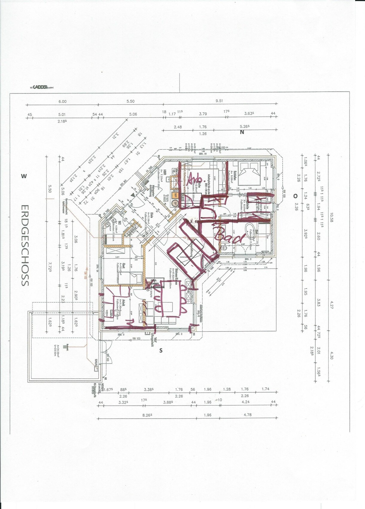

Planning origin: do-it-yourself / Scanhaus Marlow Marlow
What do you particularly like? Why? Covered terrace, open space, private area
What do you dislike? Why? small utility room
Cost estimate according to architect/planner: 270,000 €
Personal price limit for the house, including fittings: 300,000 €, 350,000 € including additional costs
Preferred heating technology: geothermal heat pump with deep drilling
Uninterrupted view from front door into garden with French doors
Floor plan is liked, are dimensions according to standards okay? Is the open space structurally feasible? Layout okay? Living area should be max. 140 m² (1,507 sq ft), which was challenging with 4 rooms.
Thanks in advance.

There are good reasons for the spacious layout. It is accessible for people with disabilities, especially wheelchair-friendly.
An open space is planned above the dining table.
Uncomfortable for some – but perfect for those who love an open-plan design and bright, airy rooms. A matter of personal taste.
The distance in the kitchen allows for cooking together without getting in each other’s way. Personally, I prefer having more space between the work surfaces rather than feeling cramped. The walk to the refrigerator may seem long but is actually manageable in practice.
The door to the office has been moved so that a sofa can be placed opposite it. Please do not consider the furnishings as finalized.

Good idea, except for the missing fireplace. We were advised against having an angled wall in the bathroom. The plan was to enter the living room from the hallway through a glazed swing door, with a view of the greenery. Unfortunately, on the south side, the view is of the semi-detached neighboring house. The terrace is private at the large sliding door and bathroom window.
If the layout works for you anyway, then why ask?
With 120cm (47 inches), you won’t really be in each other’s way—tight spots usually happen around inconveniently placed sinks, refrigerators, etc. Unless you both weigh over 120kg (265 pounds) with a corresponding frame.
Bright and open spaces are nice, I agree, but it should still feel cozy. Even a factory hall is bright and open—but who wants to live in one of those?
I don’t remember the whole thread anymore—Is wheelchair accessibility a requirement? So does one of you use a wheelchair?
If so, you’ll need to completely rethink the floor plan, because despite a lot of space being used here, it’s definitely not wheelchair accessible. For example, the toilet in the bathroom with the half wall has nothing to do with wheelchair accessibility.
