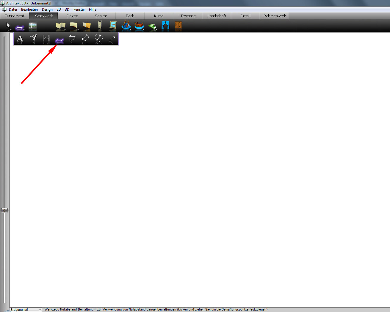

Off-topic: The software looks a lot like Architekt 3D. Try selecting manual dimensioning in the top left corner and enter the distances between the narrow spots.
Screenshot einer Architekt-3D-Software-Oberfläche mit Symbolleiste und leerem Zeichenbereich
And while we’re at it, switch to the 3D view and walk through the bathroom. How does it feel? Just cramped and claustrophobic, right? I would remove the T-shaped element. Better to have a nice corner bathtub, etc.
Similar for the laundry room. If the technical equipment is to be installed there, I think 6m² (65ft²) is lifelong torture.
It’s best not to upload images as PDFs; only a few people can read those. JPG or PNG are preferable.
