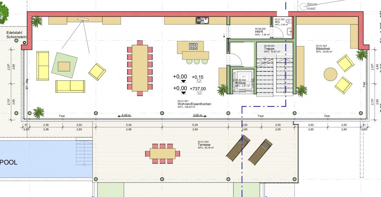

Steffen8012 Sep 2018 10:05Yes, they probably don’t really exist. KNX usually has to be done by yourself. I just didn’t want to put it so bluntly.
Nice cabin! I would like it too, but since we have three children, it might be a bit tight there.
Like many others, I don’t like the bathroom being accessible from the kitchen. I would place it on the exterior wall instead, at the end of the storage room, and reduce the storage room by about one meter (3 feet).
The pool looks good, but personally, I would prefer to use it not only in summer. It would be nice if part of it were integrated into the house. One suggestion: for me, only a saltwater pool is an option. The water feels much more pleasant.

The toilet on the ground floor is not ideally positioned. I completely agree with you there.
But the rest is perfect for us. Moving the toilet would worsen many other things, which we do not want.
Originally, we considered a natural swimming pond or pool. The regeneration zone would have been near the pavilion (which technically would not have been necessary, just for appearance), and the swimming area towards the house. However, a natural swimming pond should not be heated (above 22°C (72°F)), and some people also have a problem swimming in it because it doesn’t look sterile…
So we switched to a saltwater pool with a full-length liner.
After looking at several pools, it became clear that we wanted a stainless steel pool. This is not compatible with saltwater. There are some manufacturers offering this (made of V4A stainless steel), but the costs are enormous and durability is still not really proven.
Our pool can be heated, is insulated, and covered. So you could jump in even at lower outside temperatures (if it’s heated or not frozen over). We did not want a pool inside the house or extending into the house. Those areas should be separated. You need dehumidification (which uses a lot of energy), etc.
