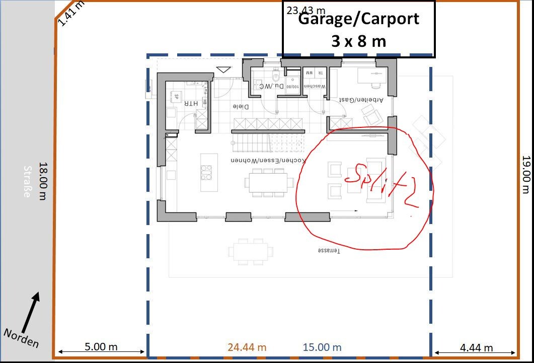

Would you then build the partial basement exclusively as a utility basement in the front area (towards the street)?
Regarding the split level, I could barely find any information (additional costs, etc.). That would make sense, for example, in the northeast corner of the floor plan or (see attachment)?
