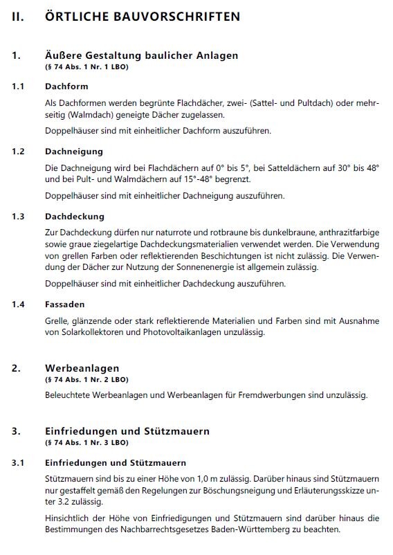

- According to the development plan, a retaining wall up to one meter high may be built to compensate for the slope; beyond that, slopes with an angle of 30° must be used (see attachment). Of course, both neighboring properties have taken advantage of this and installed suitable L-shaped retaining walls on the northeast side.

No, there is almost complete freedom regarding orientation and roof shape (see attachment).

hanghaus2023 schrieb:
The ridge directions are marked in the garage plan. Are these mandatory? At least the neighbors have followed them.
In my opinion, this garage design complies with the development plan. The house should be as tall as necessary so that the slope runs toward the street, as I have already mentioned.

[ATTACH type="full" alt="Document with local building regulations on roof shapes, facades, and approvals" width="500px">
