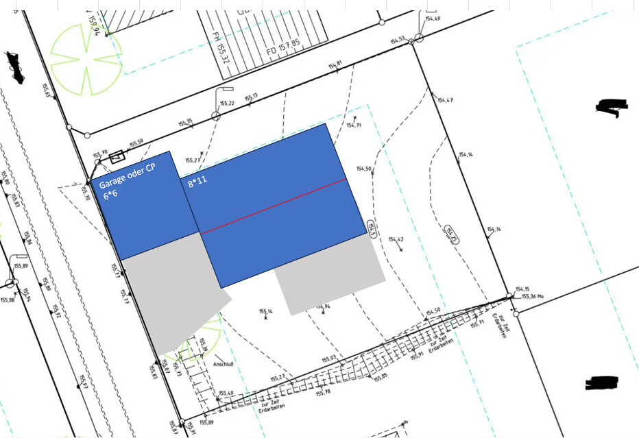

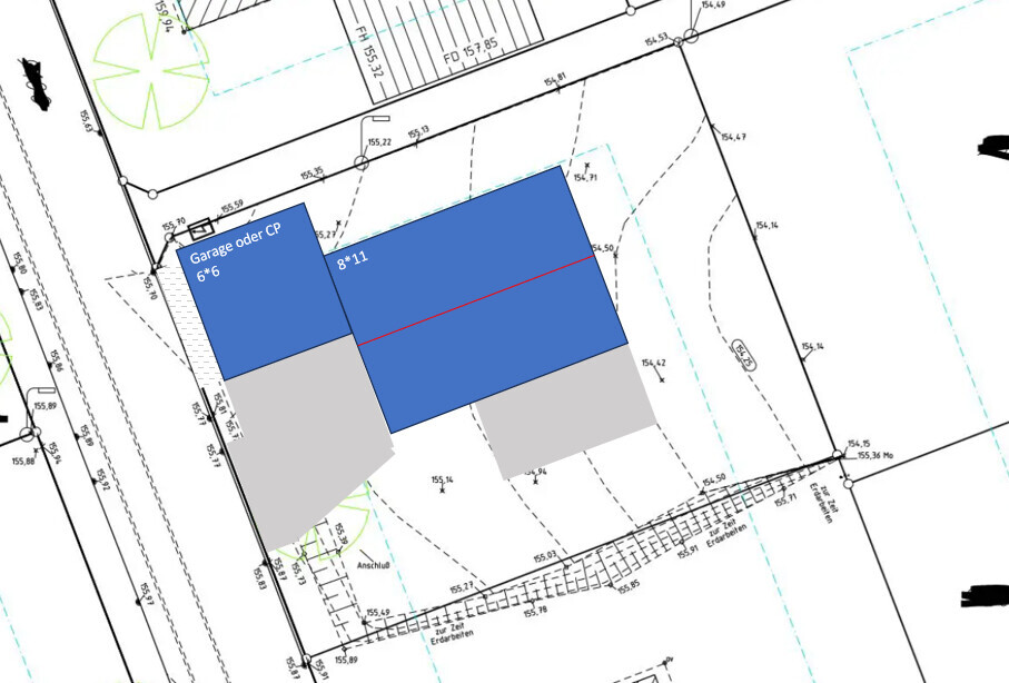

- Unlike the neighboring development, I am considering positioning the house (gable roof) with the gable perpendicular to the street (see sketch). This would improve lighting and usability of the plot.

Thank you for the sketch, so you consider 5 sampling points reasonable Two should be enough, positioned diagonally across the planned floor area. An offset of one meter (3 feet) should not be an issue.
hanghaus202330 Jan 2024 09:30Thanks for the additional documents. I agree with the architects' assessment. The reference height is 155.77 m (511.0 ft) + 5 m (16 ft) * 2% = 155.87 m (511.3 ft) finished floor level.
With the eaves height and ridge height, almost everything is possible here.
Since you are building with a basement, you probably have some leftover material that you can use for backfilling.
I would talk to the neighbor about allowing them to do the backfilling up to your property line with a slope of 2:1. This gives them the advantage of being able to build the garage, and you save on fill material.
Check if a building permit / planning permission allows a construction closer to the street. Otherwise, you will have the same issue with the access road as your neighbor to the south.
