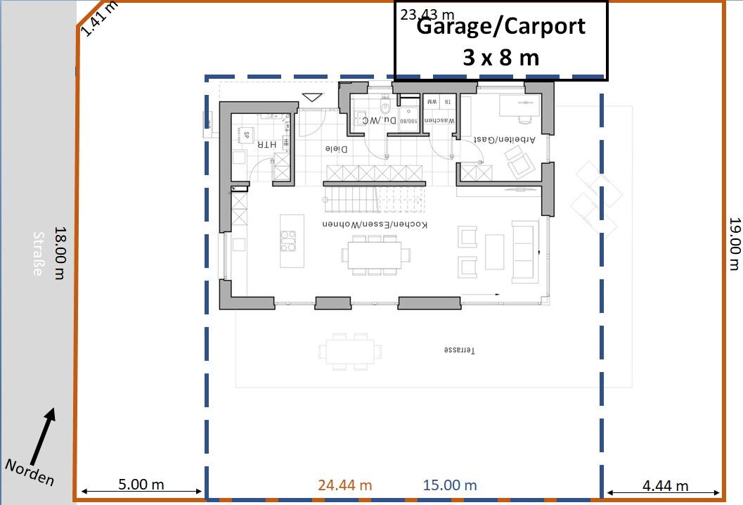

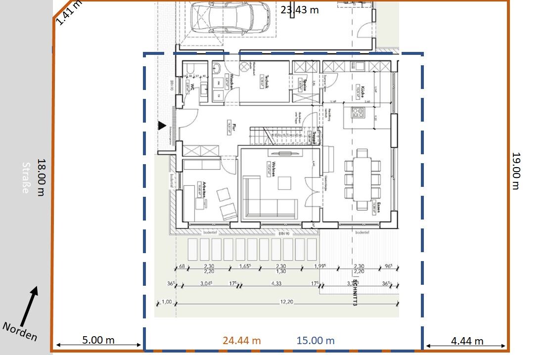

- Unlike the neighboring development, I am considering positioning the house (gable roof) with the gable perpendicular to the street (see sketch). This would improve lighting and usability of the plot.

Regarding point 1:
The bathroom door won’t work like that either. How do you expect to walk through if you just want to quickly wash your hands?
The usually open door of the washing machine or dryer could also collide with the door.
Regarding point 2:
You will need a good shading solution when the sun is shining.
Generally, there are no helpful discussions about floor plans here without you outlining your needs.
(Annoying timeout for edits.)
Regarding point 2:
