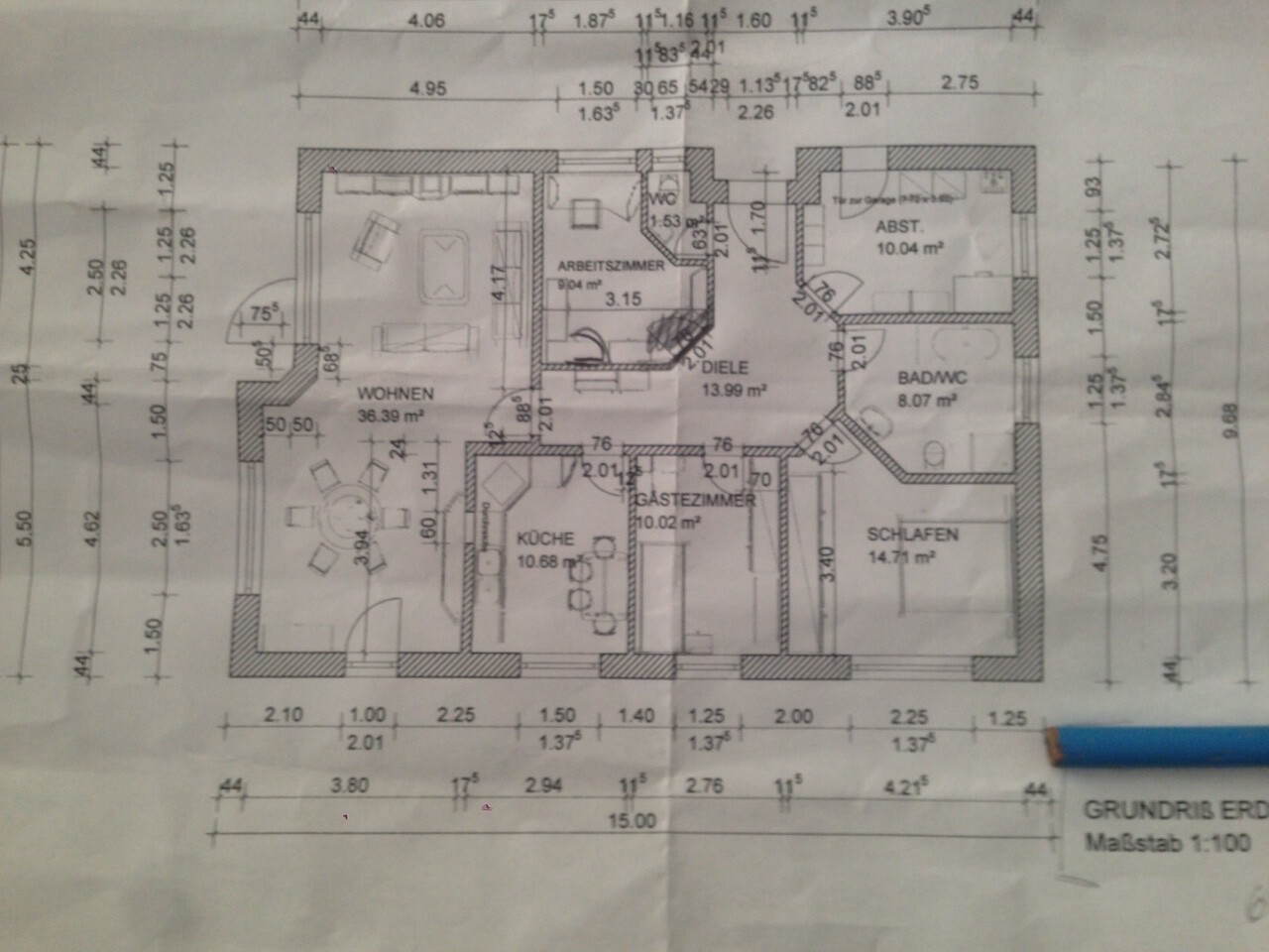

We are new to the forum and hopefully soon the owners of a nice bungalow. However, due to space constraints, we want to convert the attic (which could provide about 50-60 sqm (540-645 sq ft) of living space). It seems to be quite difficult to find a good location for the staircase. Is the hallway really out of the question because of space? Note on the floor plan: The study door is not on the slanted side but roughly opposite the kitchen door. The dining room could also be an option. We would prefer not to sacrifice the study. Oh, and the attic hatch is in the storage room.

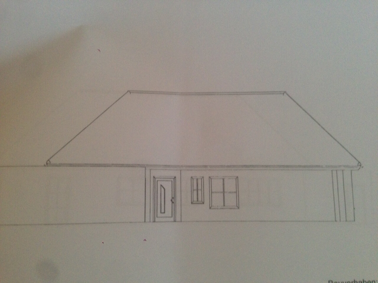

thank you for the quick feedback! It is a hip roof; I don’t know the pitch angle, but there is plenty of space in the middle with room above. I’m attaching a photo of the attic and a cross-section drawing.
We want to create a somewhat larger guest room upstairs (which might later become our bedroom) as well as another smaller room that could serve as a second children’s bedroom. Possibly a storage room as well, but that’s not a must.
Downstairs, we want to sleep in the larger room, next to it our (currently only) child. The study will remain a study. The ceiling height downstairs is “standard,” so I think about 2.50 meters (8 ft 2 in).

But this is not a section drawing. And on top of that, the drawing has no dimensions—how is anyone supposed to guess anything from that?
Also, the floor-to-ceiling height, including the ceiling thickness between the ground floor and attic plus the room height, would be a useful measurement.
The same goes for some indication of the intended staircase design.
