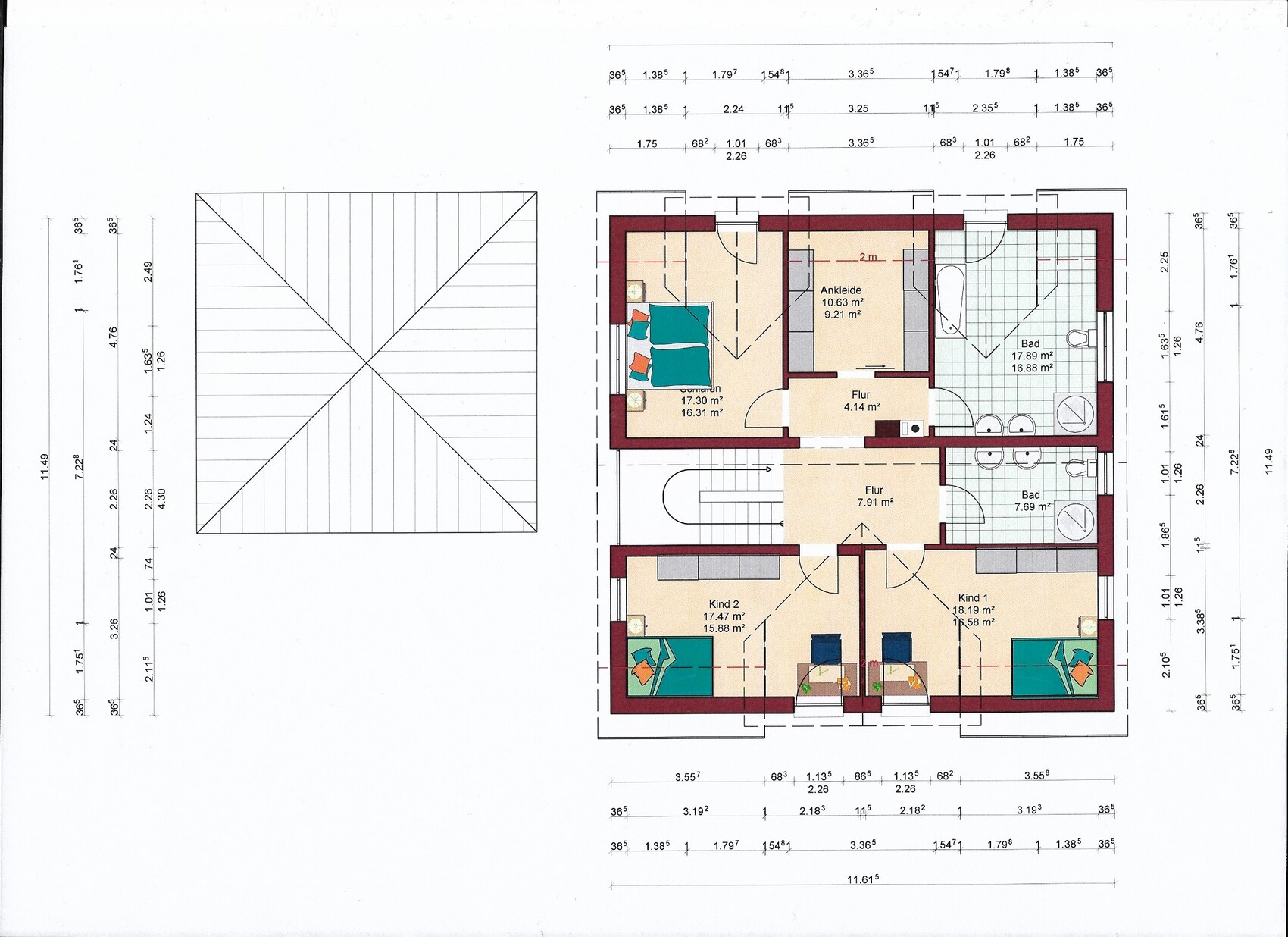

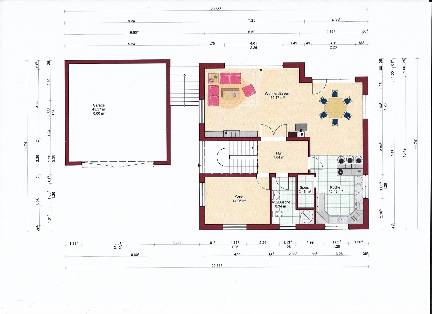

This is a single-family house on a hillside with a basement. The entrance is planned between floors, and the stairs lead directly to the “ground floor” and basement. Towards the street, the basement projects significantly above ground level; towards the garden, the ground level aligns with the ground floor, allowing a level exit to the terrace. To get some independent opinions on the overall planning and floor plan, we would appreciate feedback. Please ignore fittings such as kitchens and bathrooms—they are just placeholders in the plan.
Edit: I forgot to mention that currently some doors in the plan do not fit exactly. This is due to larger changes in the overall plan, after which detailed adjustments have not yet been made.
Couldn't a design that follows the terrain more closely be found instead of this elevated ground floor arrangement? From the street side, the house appears quite bulky. A gable roof on the house combined with a hip roof on the garage looks a bit odd; the dormers help to balance this. You enter straight into the basement from the entrance, and only secondarily access the living area (? ? ?).

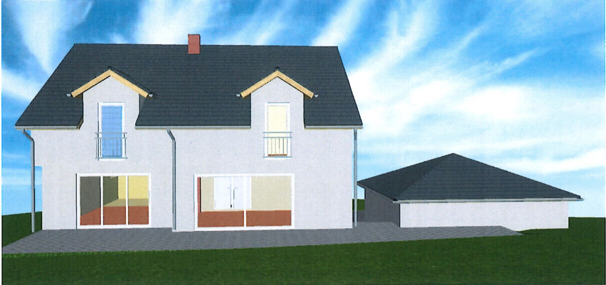

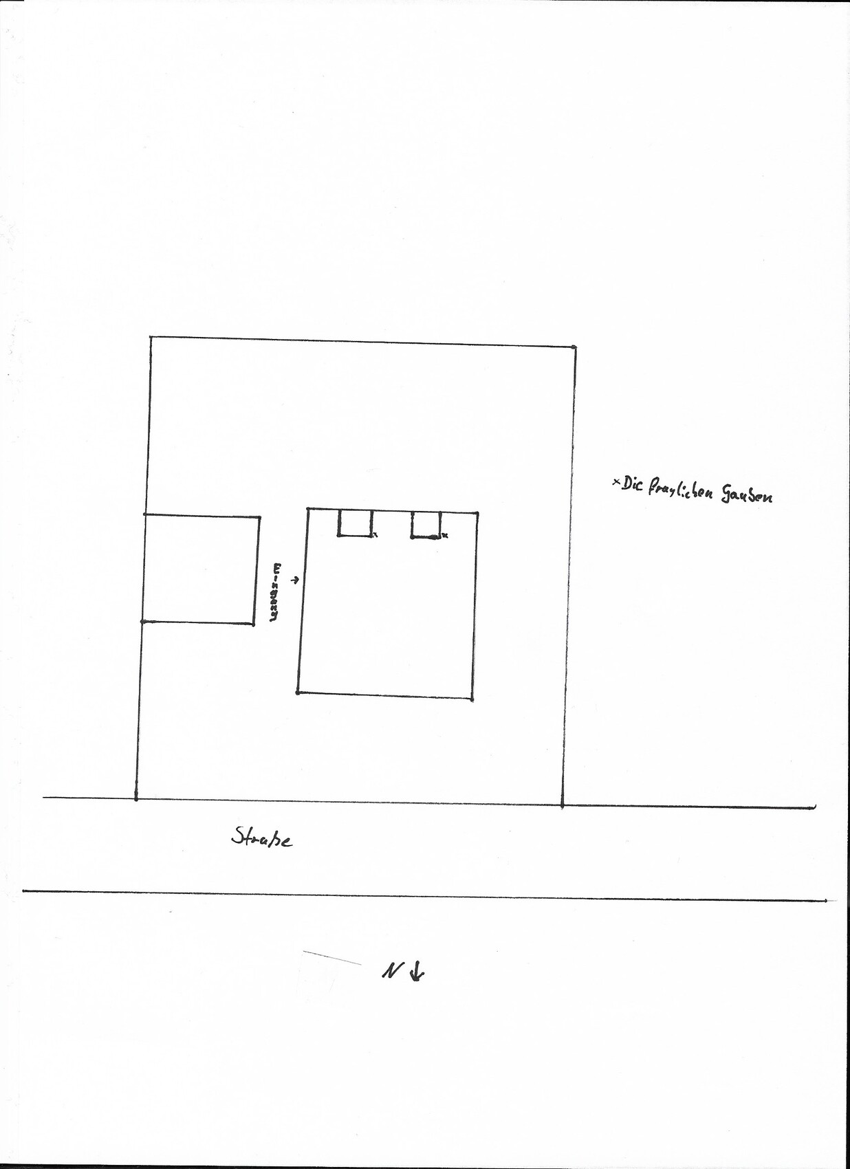

@ypg Now it's getting serious—I’ve sketched the orientation of the house. I hope the important points come across. The small strange squares inside the house represent the dormers I’m concerned about. These face south. I’ve also attached the rear view of the house with the dormers.

@11ant The garage situation is settled; it will now have a flat roof. The entrance is halfway between the basement and the main floor (“EG” in German), meaning you go half a story up into the main floor and half a story down into the basement.
I am open to ideas for a solution that fits the terrain better—I can see that from the street, it looks quite like a tower. However, I have the limitation that the basement, at least partially below ground level, is a must, and I cannot carry out excessive earthworks that would significantly alter the plot.

The entrance is positioned halfway between the basement and the ground floor, meaning you go up half a flight of stairs to the ground floor and down half a flight to the basement. At this nominal midpoint, the direction with the straighter path tends to feel dominant. Therefore, I would suggest changing the circulation route.
