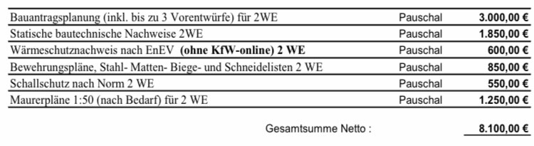

There is not enough information to make a judgment. Use an HOAI calculator as a reference. Enter the eligible construction costs with the average rate and phase III, and it will show you the fees an architect is allowed to charge according to HOAI for each phase, plus 3-5% additional expenses.
We commissioned up to service phase 4 (€4500, not according to HOAI); after that, our construction coordinator took over.

Approval planning? Detailed construction planning? Or just three drafts?
What about structural engineering, energy saving regulations, etc.?
To protect yourselves, familiarize yourselves with the topic first. Then ask if the price is appropriate.

For which design phases exactly? Are you sure you are interpreting the three designs correctly?
Is the semi-detached house a mirror image layout or is each side individually designed?

Katrin Freya
1 Apr 2020 15:02
Thank you very much for the quick responses!
I have attached the offer here; maybe it will help.
I still need to do more research on the topic...
Cost overview of construction project: planning, documentation, thermal insulation, reinforcement, soundproofing; 8,100.00 €
