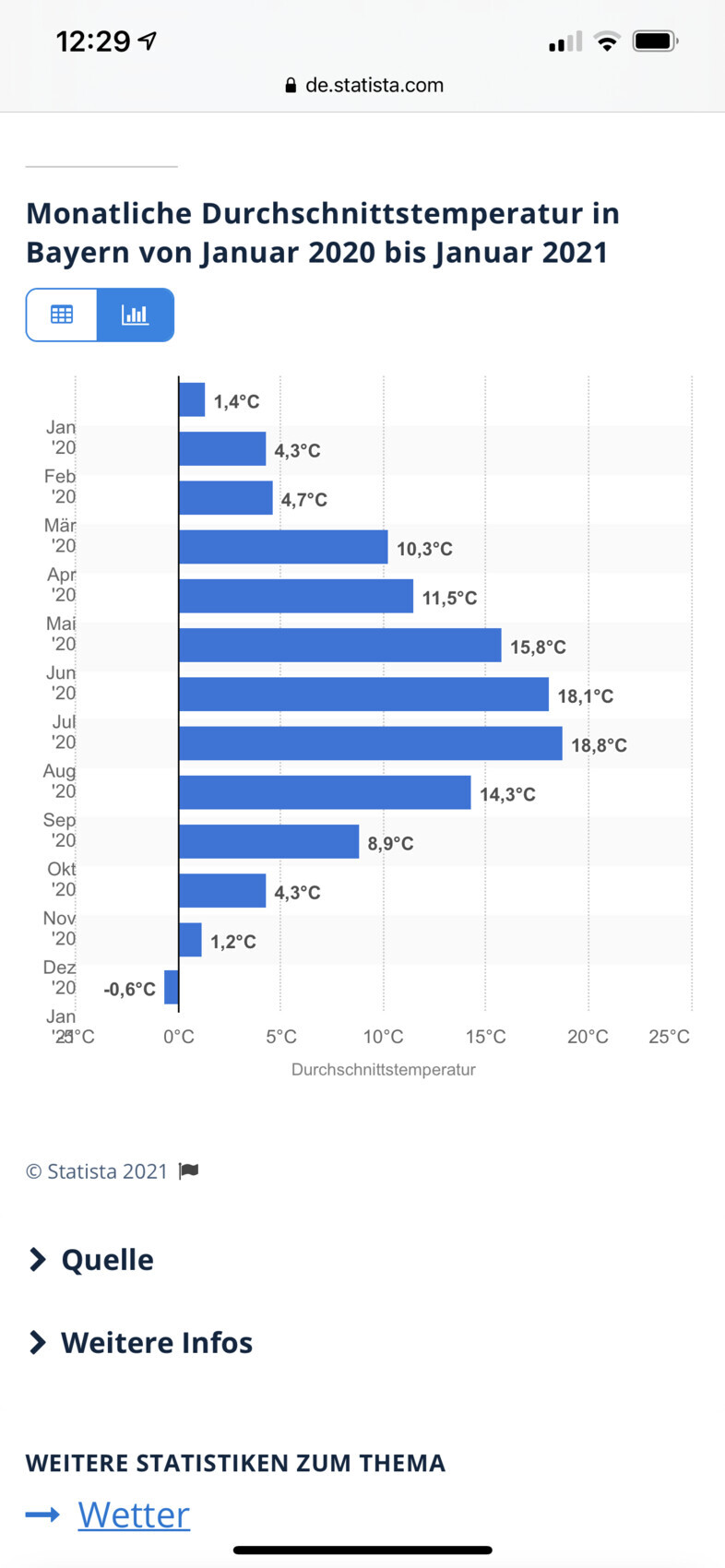

Nope...
Monthly average temperatures in Bavaria (Jan 2020–Jan 2021), -0.6°C to 18.8°C (30.9°F to 65.8°F)
Bookstar
15 Feb 2021 13:47
Zaba12 schrieb:
Then I heat partially into May without ERRs.
Nah...
[ATTACH alt="2BB5FDD0-B174-4986-9088-DDC30AAAC867.png"]57529[/ATTACH]
Yes, it’s quite normal to heat until May, of course much less, but there are still very cold nights and so on...
Alessandro
15 Feb 2021 14:17
I agree! If the cold nights are not over, the heater keeps going into May!
