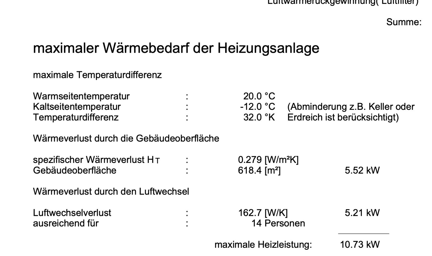

We are hopefully approaching the goal. The energy consultant included this passage somewhere in his calculation for the KFW55.
He passed this on to Vaillant, and they added additional restriction periods from the heat pump tariffs, and suddenly I ended up with the 10.5 kW heat pump. Anyway, he mentioned something about me having a heating load of 10 kW, so hopefully this screenshot is relevant.
Of course, I only sent the installation plan and the things posted here. I forgot to send this standard form with the standard heating load and the actual heating load. I have corrected that, and he will now send it to Vaillant again, so instead of a 10.x kW heating load plus restriction periods from the utility, we might get a heating load specification of 6.2 kW (standard) or 5.78 kW WITHOUT utility restriction periods. Let’s see what comes out.
Between the lines, he even seemed to apologize. He doesn’t want to install oversized heat pumps himself, but he didn’t have any other data...
It’s getting there. Not as great as I imagined, but better than the standard!
