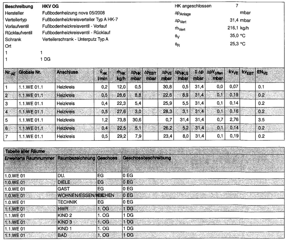

Hello everyone!
Our calculation was probably done in a standard way and unfortunately based on a 35°C (95°F) supply temperature.
So far, I have only received the attached overview for BAFA, but I don’t really understand it.
Could someone please comment on the information or let me know if I should request additional documentation?
Technische Tabelle: Fußbodenheizung mit Ventilen, Druck- und Durchflussdaten.
Technische Tabelle zur Fußbodenheizung mit Verteilern, Ventilen und Raumdaten.

netuser schrieb:
Hello everyone!
Our calculation was probably pretty standard and, unfortunately, based on a 35°C (95°F) supply temperature.
So far, I haven’t received more than the attached overview for the BAFA, but I’m not really able to make much sense of it.
Can someone comment on the data or let me know if I should request additional documentation?
You should ask your installer to explain. What’s missing here are the room names, heat demand per room, under- or oversizing, design temperatures, heating circuit lengths, temperature spread, and so on.

Your calculation is not yet a detailed heating load calculation. Our document is 35 pages long. We only have a bungalow with 90m² (970 ft²); for a larger building, there would certainly be more pages.
