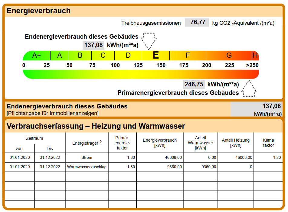

I recently purchased the house and have not yet lived in it, so I cannot provide my own consumption data at this time. (There are 2 adults and one baby in our household).
Before moving in, I am planning a renovation. The previous energy consumption was quite high, which is likely due to the former use by a large family and the electric underfloor heating that consumes a lot of power.
I have attached the previous energy consumption data.
nordanney11 Sep 2024 09:21asaid10 schrieb:
My energy consultant performed a heating load calculation, showing a standard heating load of 8,303 W.With that, I would install a 7 kW monoblock system from Pana (though I am a fan of it).asaid10 schrieb:
Existing insulation in the roof and on the floor ceiling below (will not be changed)Renovation and you won’t change anything there? What kind of insulation is installed? With good insulation, I would have guessed even a 5 kW monoblock.nordanney schrieb:
I would install a 7kW monoblock system from Pana (I’m a fan of that too).
Renovation and you’re not doing anything with it? What is installed currently?
With good insulation, I would have guessed a 5kW monoblock would be enough.From the heat load calculation, I understand that at least an 8.3 kW heat pump is needed, right?
I’m still unsure which one is the right choice, since the heating contractors give different advice.
The ceiling of the upper floor is insulated, but it’s also quite old. It dates back to 1990, so 34 years old. I would leave it as is for now and not do anything, since my budget doesn’t cover everything.
I wouldn’t install a photovoltaic system for cost reasons at the moment either (maybe in 2-3 years, but I’ll already lay empty conduits for it).
