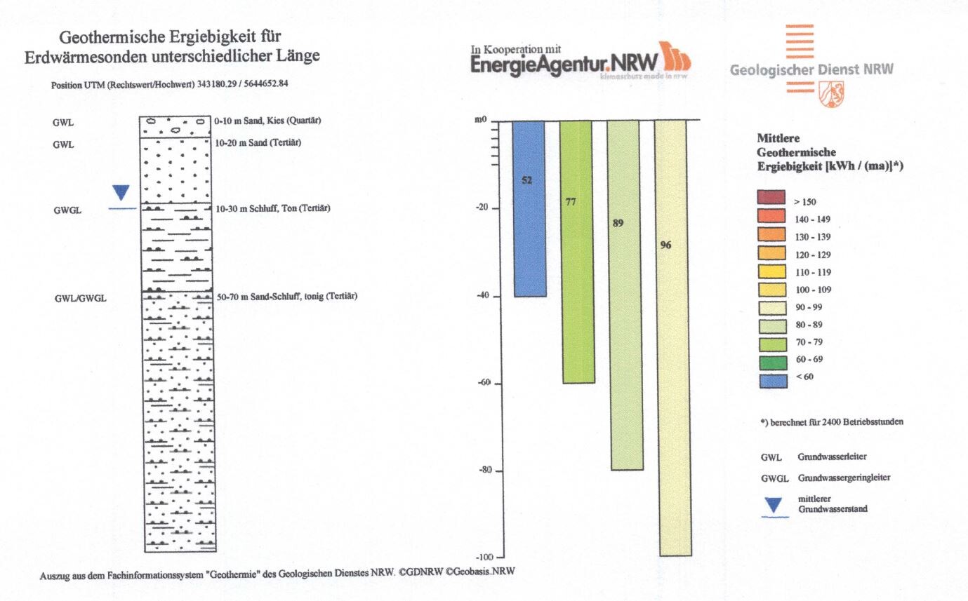

R.Hotzenplotz6 Jan 2018 23:03Alex85 schrieb:
Energy from groundwater is a water-to-water heat pump and the most efficient option available. Very good!The groundwater level can be found in the attached document. Which authority should I contact on Monday to clarify whether we are allowed to do something like this? If this is the best solution, I should at least check if it’s feasible.
Alex85 schrieb:
It’s a shame that the general contractor charges so much for the horizontal collector (or trench collector). Both the collector costs and the earthworks are way overpriced.He just gave an estimate for the earthworks. As the property owner, I have to arrange the earthworks myself. But even with the €35,000 he calculated for earthworks to prepare the site, he was quite close to the actual cost.
We heat about 250m² (2,690 sq ft) of living space. From what I’ve read online, you need about twice the area for the collector surface. It can’t be asphalted, and no trees, pools, or other structures can be placed there. That would be 500m² (5,380 sq ft). I can imagine that a lot of digging would be required. But with such a large area, it doesn’t seem reasonable to limit yourself so much.

Water-to-water heat pumps are very rarely used in relation.
You need two wells. Water is extracted from the first well, passes through the heat pump where energy is extracted, and then it is discharged back into a second well.
So, the first well must have sufficient yield, and the second one must be able to receive the water again.
This means you will also face drilling costs.
Furthermore, the water must have a certain quality. Otherwise, there can be significant issues with the heat pump.
In addition, (I’m not sure) the local water authority at the lowest level has to approve it. Whether they will, I have no idea.
I don’t want to offend you, but could it be that the general contractor is overcharging you? Obviously, you are taking everything from one source, and they are making a hefty profit from you.
The earthworks for shallow collectors might be around 2 x 5 hours, provided the excavated material can be stored on site. The quote is quite overpriced. You can surely find your own excavator and operator.
