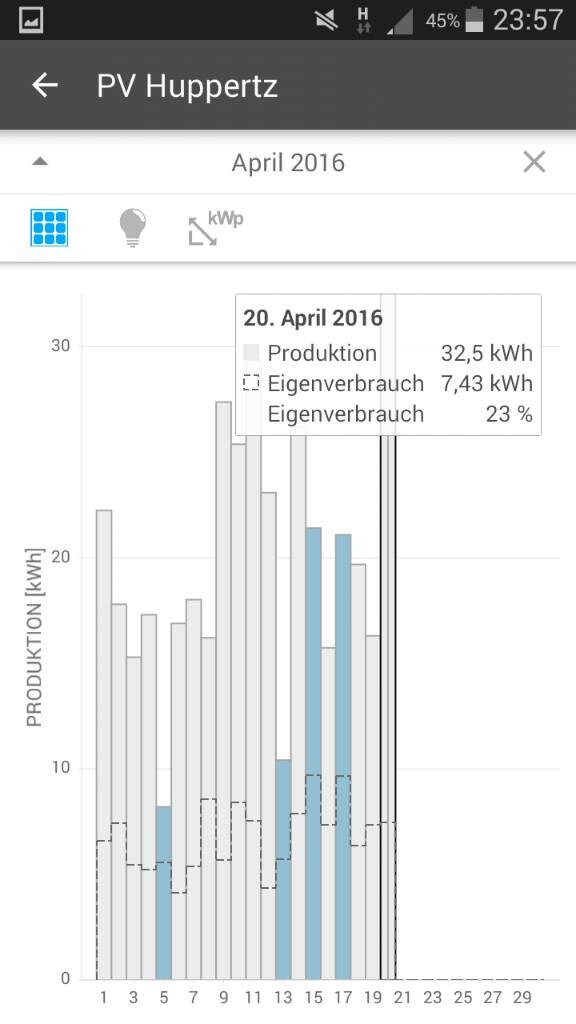

Well, the energy meter has been installed since Monday.
The battery is integrated. I’m seeing initial readings, which of course are not yet conclusive.
We’re currently hardly buying any electricity... just producing, selling, storing, and self-consuming. Even on cloudy days, the output is sufficient, partly from the battery, which still gets fully charged again by the evening. It then lasts despite power-hungry refrigerators until about 3:30 a.m. before grid supply is needed.
The system doesn’t actually show any peaks... it runs very steadily from early morning until late. A very nice gadget.
I’m clear with the tax office; I still need to register as a business. The utility company still needs the BNETZ-A number... all in progress.
So, apart from a few pieces of paperwork, the project is successfully completed.
Elina schrieb:
What is your base load? If the full battery only lasts until 3:30 AM, that’s not really long, or depending on how many kWh are used in the evening... it probably looks somewhat better in summer.About 4-5 kWh run overnight.
The old refrigerators... ventilation...
But the battery is small: 2 kWh.
Of course, it’s better in summer – I think from October to February it’s mostly “running low.”
PS: Currently we consume about 12.5 - 14.5 kWh per day.
