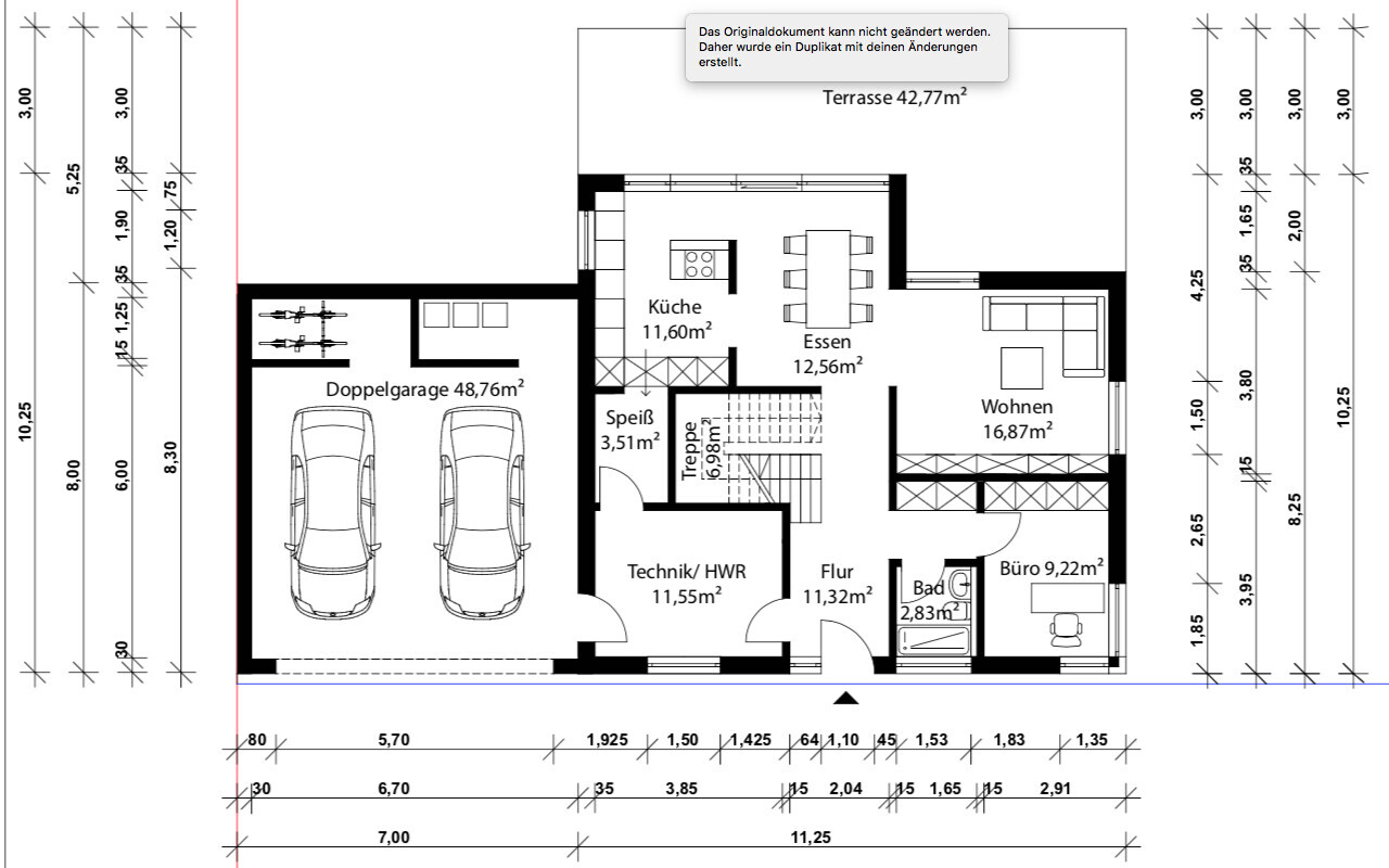

Kirschsaftlady27 Oct 2024 16:38Thank you for the tip! Here is the ground floor plan. The north arrow is unfortunately not that simple, as it is exactly over the architect’s logo, which I obviously do not want to show. I have uploaded the site plan again with the arrow, but unfortunately it is cropped at the bottom.
As additional information, there is currently no neighboring development.
Oh wow!
May I ask what idea this design is based on? I don’t see your requests being considered, and there are also fundamental planning issues that seem completely off here. Were there any other specific requirements?
Is the budget so low that it is insufficient for proper planning?
How do you turn a nice utility/technical room into a passageway with no added value? Give it three doors and position them in a way that a wall becomes unusable.
And how do you squeeze sanitary fixtures into the bathroom that you actually want to use?
Phew!
Kirschsaftlady27 Oct 2024 18:27Thanks in advance for your feedback! We hadn’t really considered the utility/technical room, but you’re right—because of the walkways and the window, you really can’t place anything there.
As mentioned, the draft was developed after the site visit as a brainstorming session between the architect and us. Based on our room program with approximate size specifications in square meters that we provided beforehand, he prepared an initial sketch. We then shared what we liked and disliked, and from there he started drawing while we continuously intervened if something didn’t fit at all or if we had our own suggestions. That’s how the ground floor was created, which we actually liked quite a bit in the rough draft; the upper floor, however, we already criticized at that stage. We assumed he would significantly revise the entire plan, check it for feasibility, and possibly rethink everything again based on all the wishes and dislikes he learned during the meeting (also noted by his secretary) if the overall design didn’t work out.
The fixed requirements are basically just the room program, the budget, the roof ridge direction parallel to the street, stair design either straight-run or with a landing, the location of the master bedroom, the living-dining-kitchen area facing the garden, and at least the living room somewhat separated or without a direct view into the kitchen, with the kitchen featuring an attached island that allows a view into the garden.
We have seen many things in show homes or catalogs that we liked, but some of these were also incompatible or we didn’t know the pricing implications, so we found it difficult to express more concrete wishes.

I can only agree with @ypg.
You can definitely make much better use of the available space.
For me personally, there are too many corners (both inside and outside). If you remove the recessed wall in the living room and make the house rectangular, you gain several square meters (square feet) and the layout becomes simpler as well.
