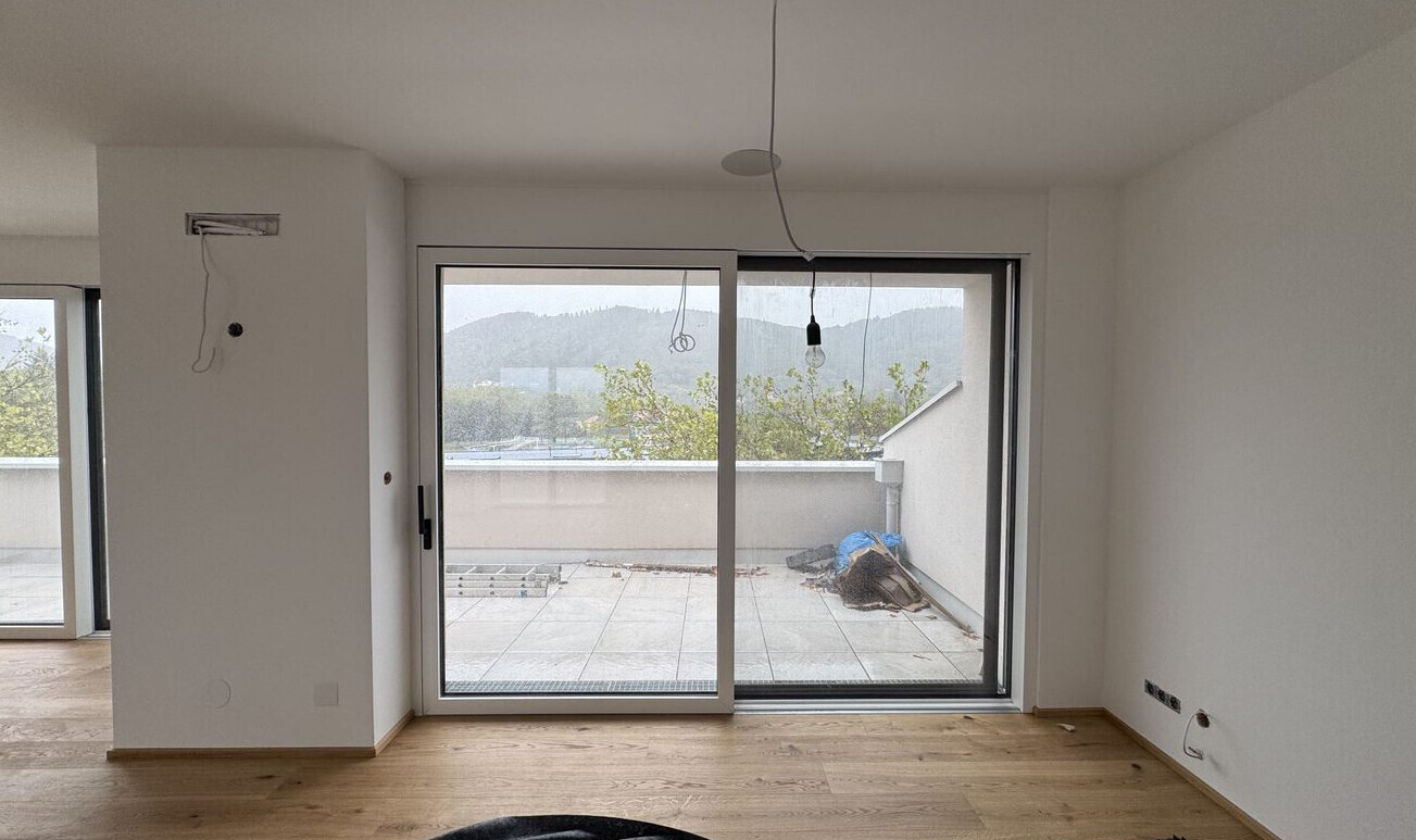

ArminJG2222 Oct 2024 10:29As a reference: We built with a developer (who then subcontracted a general contractor) and for us, the lift-and-slide door at 3.6m (12 feet) wide and an increase in height from 2.2 to 2.5m (7.2 to 8.2 feet) cost about €4,000 net extra. The windows are Kunststoff-Aluminum (uPVC-aluminum) from Internorm with triple glazing.
Since we built with a developer, we had no option to assign this topic elsewhere.
But it was worth it:
