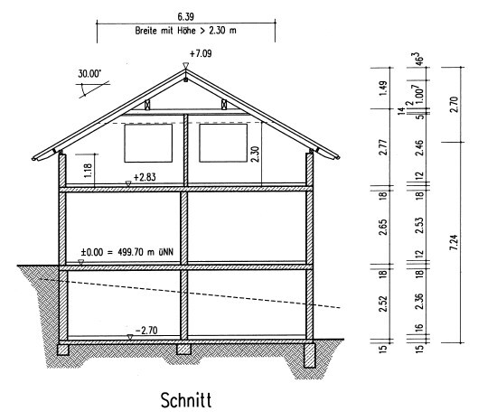

Dachshund903 Aug 2023 09:49Hello everyone,
The submission of the building permit / planning permission has unfortunately been delayed a bit. However, this isn’t a problem, as with the current rainy weather, excavation work wouldn’t be ideal anyway.
This provides an opportunity to take another look at the house’s cross-section. I would appreciate it if you could review it once more and give feedback on whether it works as is or if anything should or could be changed from your perspective.
One small note: According to the architect’s calculations, the house extends an average of 0.90m (3 feet) above the original ground level, resulting in a total height of 7.99m (26.2 feet) above the original terrain, which nearly reaches the maximum ridge height of 8m (26.2 feet).
Many thanks and best regards
