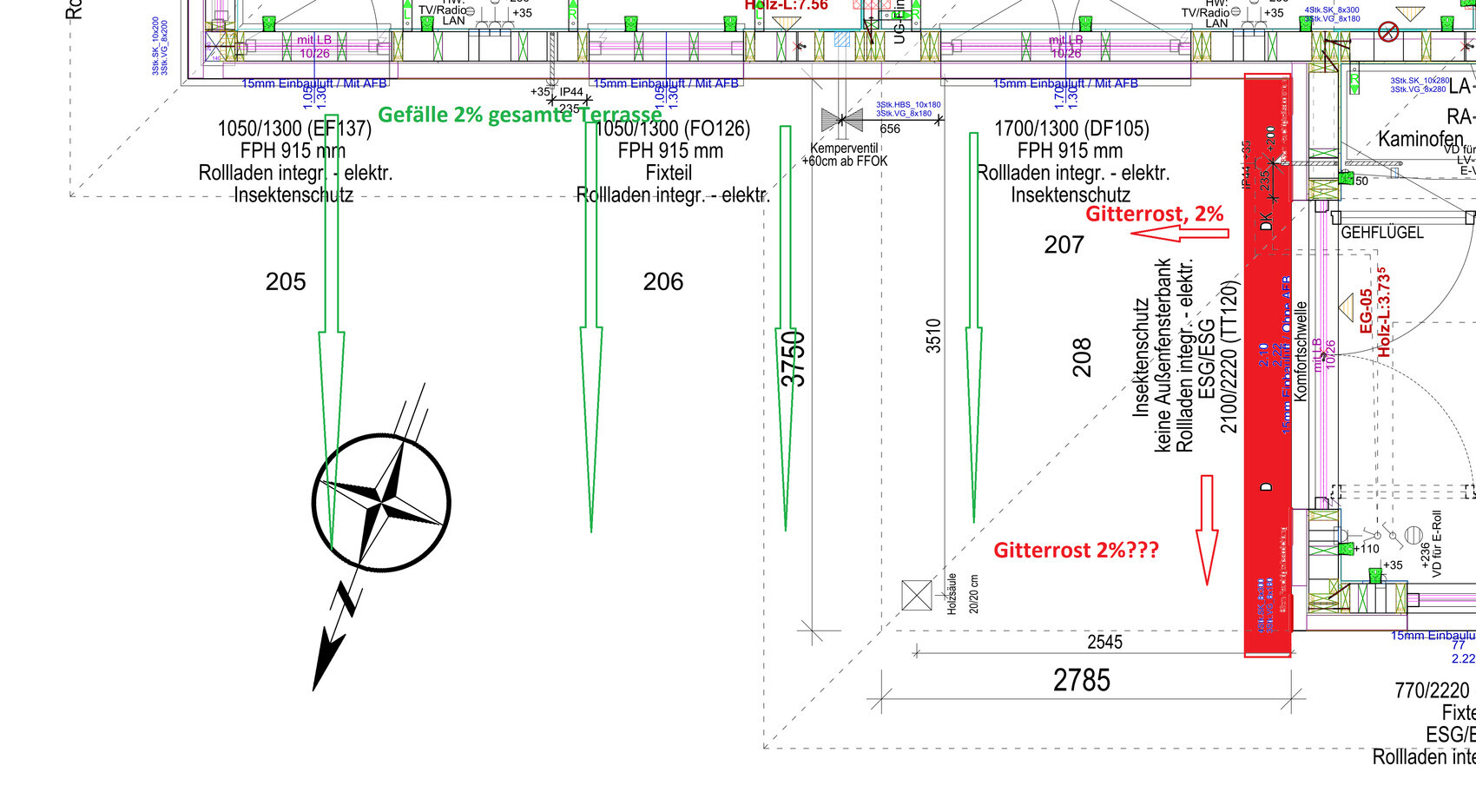

But I’m not sure if I should install the grate following the slope right away. Here is a picture of the terrace.
The issue is that the grating is 3m (10 feet) long when placed along the entire edge of the house. At a 2% slope, that results in a height difference of 6cm (2.4 inches). Is this the usual approach? I don’t recall seeing a grate installed with a lateral slope anywhere before.
WilderSueden25 Jul 2023 18:27Now things are a bit clearer. I wasn’t expecting an L-shaped floor plan. And when I read "comfort threshold," I can understand the oversized drainage channel. Basically, it would make sense to have a slope from the top right of the plan down to the bottom left to direct water away from the house.
The larger part of the terrace is adjacent to the house at the top of the plan, so I would definitely create a slope away from the house there. Whether it needs to be 2% or if 1% is enough is up to you. The main point is to ensure that water from regular rain does not run against the exterior wall. From the right side of the plan moving left, you could actually have no slope, but then you would rely entirely on the drainage channel during heavy rain and on it not becoming blocked by leaves that have been decomposing there since the autumn before last. For this reason, I would recommend at least a 1% slope there as well.
