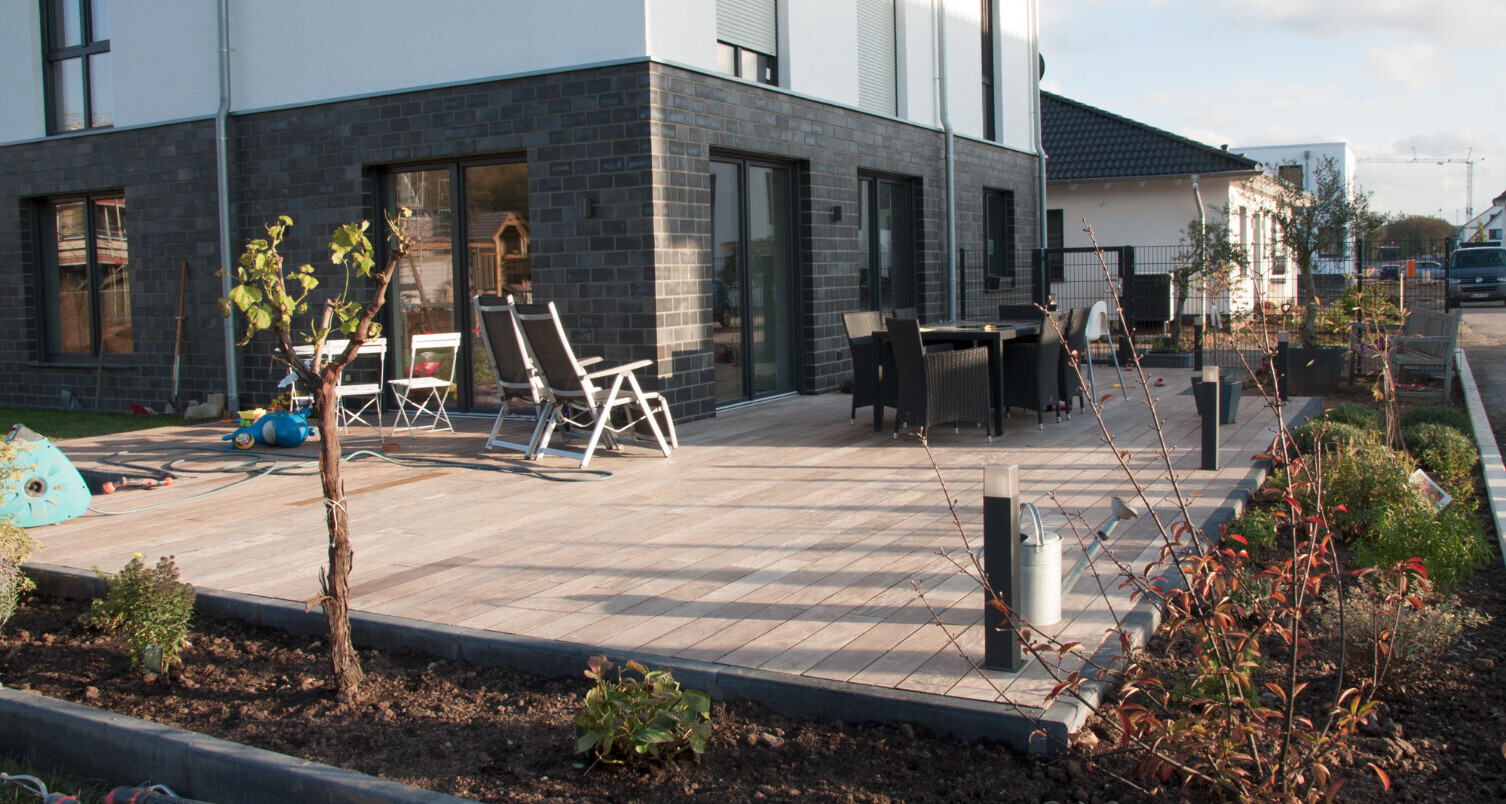

My personal experience: Bangkirai (which I don’t like anymore because of the color), thermally modified ash (great for feet and a nice brown color), IPE (that was the highlight, but very hard on tools since it’s extremely dense – we had about 75 square meters (800 square feet) of it). Next year I’m building a new deck (new house again), also with wood.
This is what IPE looked like – even after three years.
I don’t have photos of the others — but more than cleaning and oiling (we didn’t want it to gray) was never needed. The thermal wood still looked as good after eight years (+ oiling) as it did when installed. And that was on the north side of the house.
