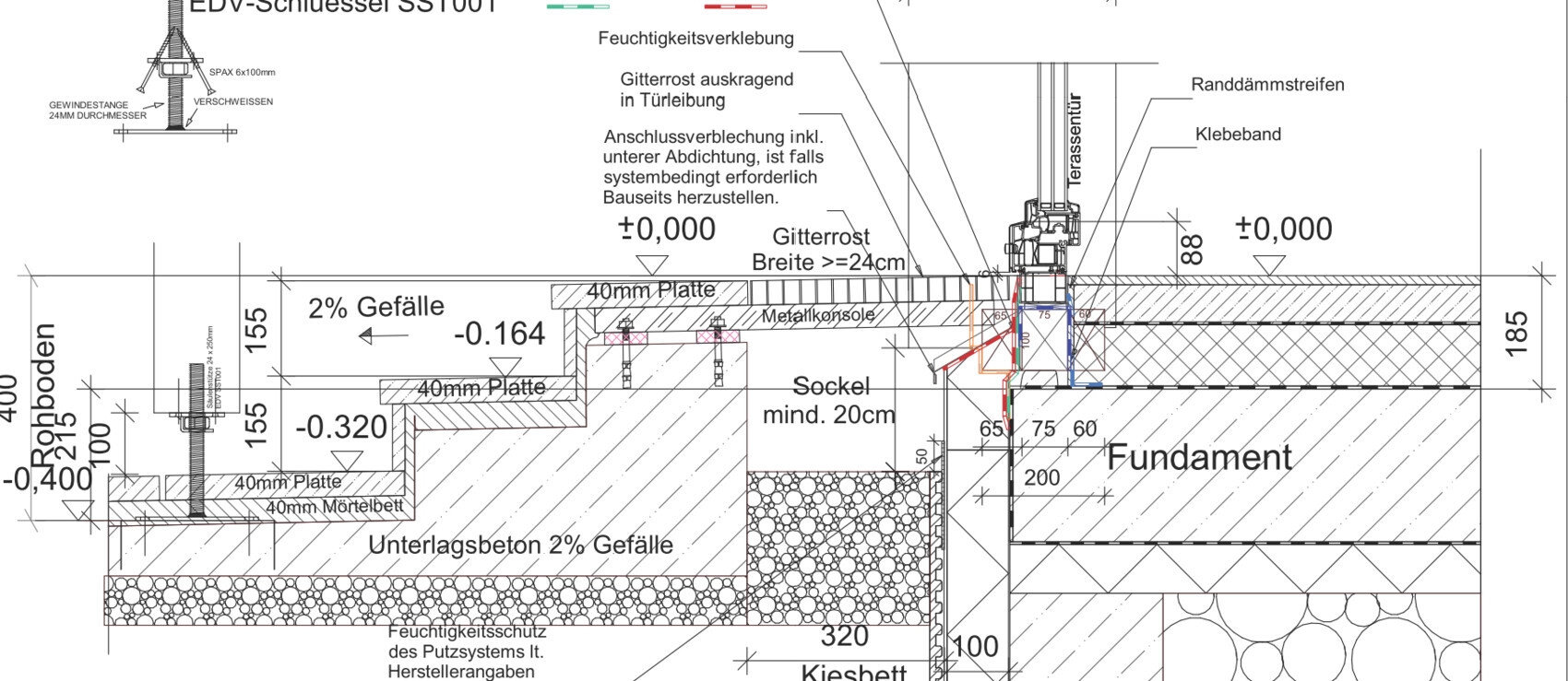

We have a terrace that measures 3 x 5 meters (10 x 16 feet).
If we roof the entire area, it could be 7 meters (23 feet) long, but that is not currently planned.
My question is in which direction we should create the slope. I would make it slope to the left, with a 2% gradient.
This means the slope would lead away to the left when stepping out from the patio door.
So far, so good...
The precast company requires us to install a drainage grate at least 30 cm (12 inches) wide starting from the door. This grate should have a 2% slope toward the front.
Now the question is whether the grate should also have a slope to the left.
Thank you very much for your help!

The prefabricated components company specifies this for usWhat kind of company is that? And may I ask: why a drainage channel, if everything is generously covered anyway?
And may I ask: why use a drainage channel when everything is generously covered anyway? Yes, I was wondering the same.
Elk.
They even included a representation in the construction plan.
Here with a setback step.
