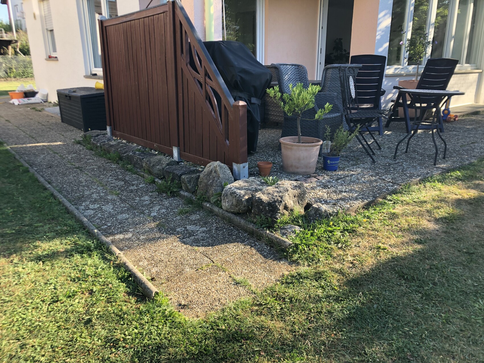

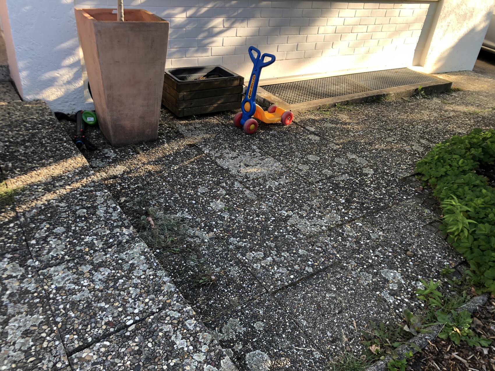

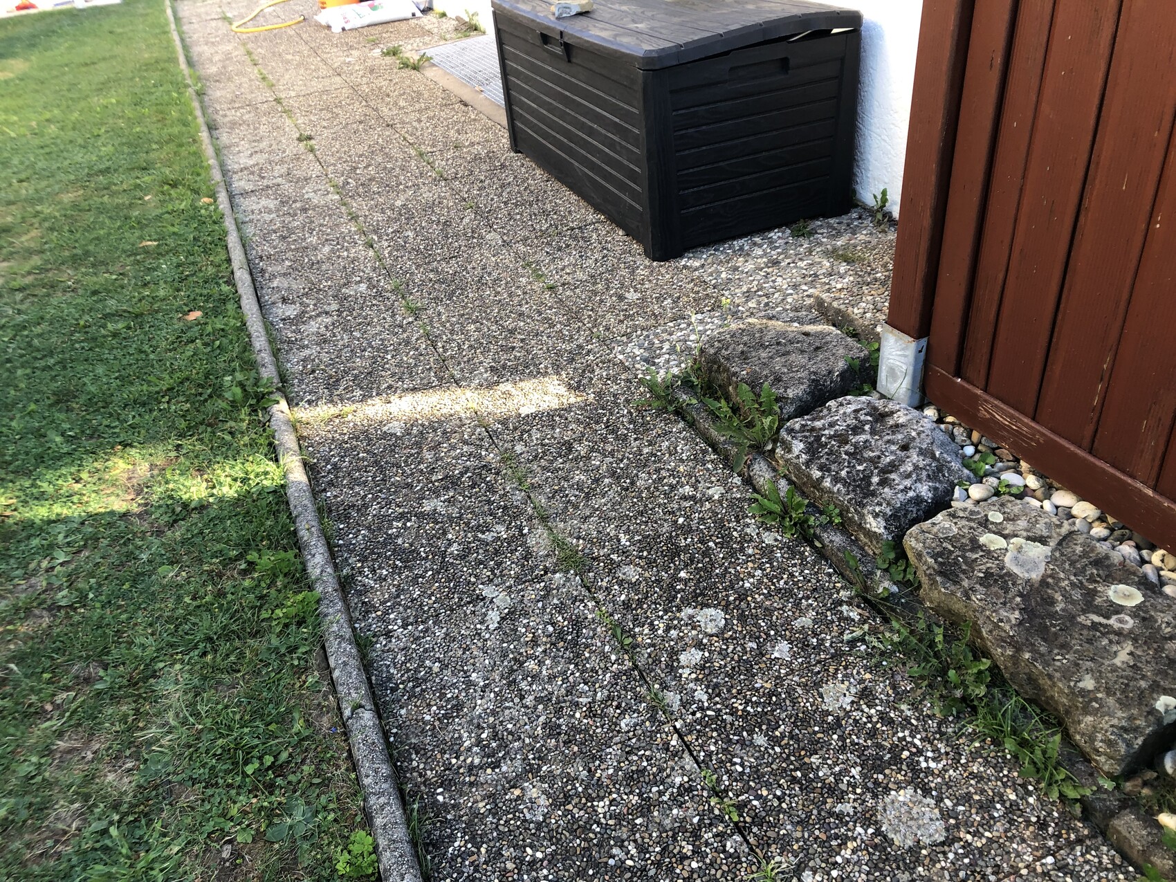

In the last picture, you can see the terrace and path from the southeast (as shown in the sketch).
The wall will be removed, and we are trying to compensate for the height difference by giving the terrace a 1% slope towards the east and south. Currently, the terrace has no slope.

In the last picture, you can see the terrace and path from the southeast (as in the sketch).
The wall will be removed, and we plan to compensate for the height difference by giving the terrace a 1% slope toward the east and south. Currently, the terrace is flat with no slope. Are there any ideas? I would really appreciate your feedback :-)

Thanks for the pictures. Okay, redoing it once is understandable – but I’m generally not a fan of exposed aggregate concrete 🙂.
The lawn edging stones will be replaced too, right?
You definitely need some sort of edge restraint (curb, wedge, adhesive, fixed bedding layer, etc.) so that the pavers in the outermost row don’t shift.
The lawn is currently higher than the pathway itself, isn’t it?
Everything will have to be removed anyway at this point. I would seriously check the condition of the subbase to see if it’s in good shape.
It would be quite unfortunate if you put all this effort in and then the pavers settle unevenly.
Do you currently have a flush transition to the terrace, or is there a step from the door to the terrace?
Depending on the required heights in general, it might make sense to adjust the base construction accordingly to even out the levels.
That might not be so simple, considering there are also prefabricated light wells and so on that need to be taken into account.
How large are the height differences at the moment?
Where the path meets the terrace, you could try to grade the slope appropriately to smooth out the level differences.
But as mentioned, some more details are still missing. What size are you thinking of for the pavers?
