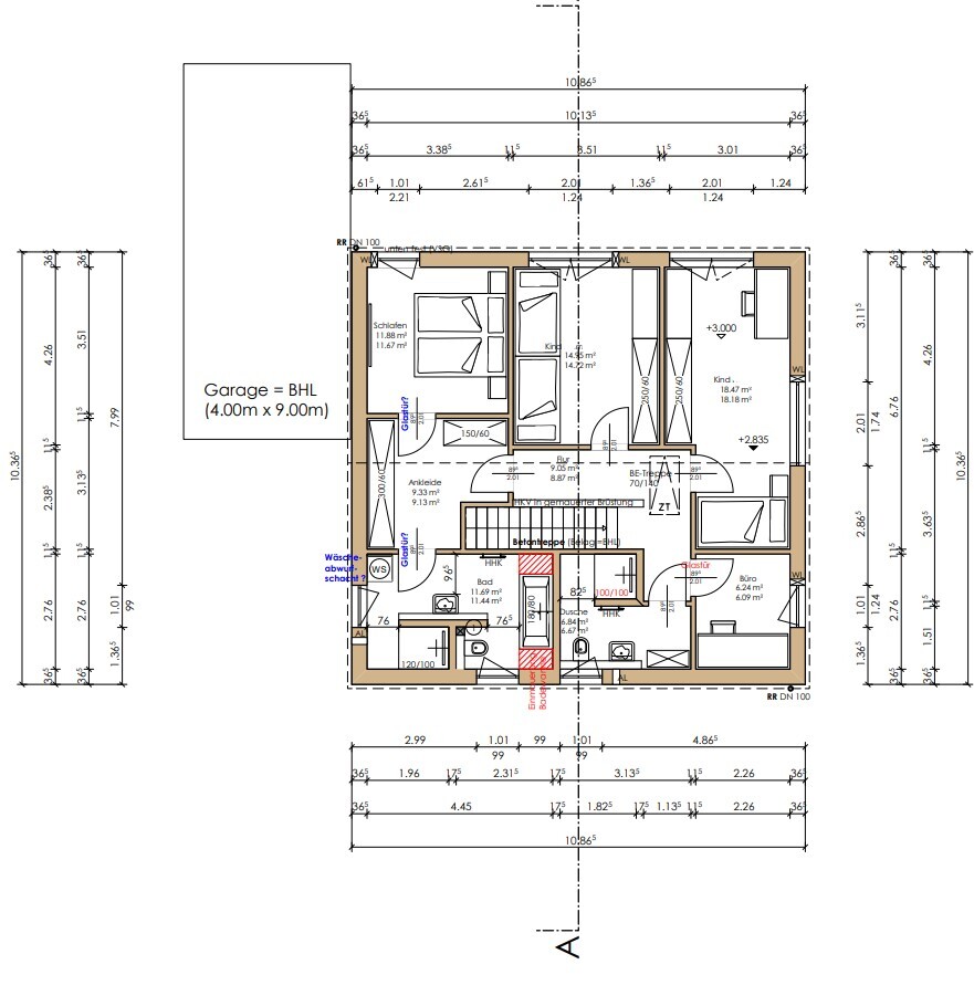

Here are the current designs.
We’re still unsure about the following:
Ground Floor
- Should we remove the shower downstairs? It’s mainly intended to clean the kids and me up when we come in muddy from outside.
- Giving up the hallway closets to enlarge the living room. Then we would only build one closet under the stairs and maybe create a small coat area near the guest bathroom.
- We are also uncertain about the windows and their arrangement. We’d appreciate your opinions or ideas.
- Whether or not to include the partition wall between the living room and dining area.
Upper Floor
- We are considering reducing the size of the shower in the guest bathroom upstairs, which would also reduce the hallway size and make the office larger.
- We’re unsure about having a walk-in closet without a window. We’d like to keep our existing 3-meter (10 feet) wardrobe, so it’s currently designed that way.
One more question on the side:
The neighbors have already installed L-blocks or similar retaining walls to level their land. Can I simply use the “backside” of these (and fill up to that level), or do I need to install my own L-blocks (or similar) for support?
That’s where we are right now.
