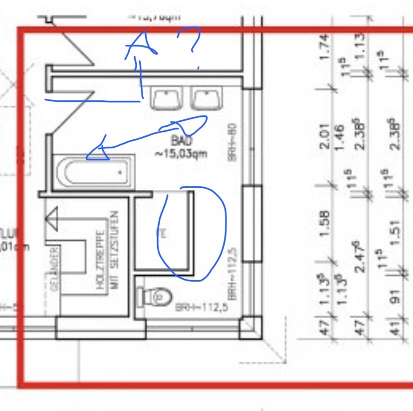

2D doesn’t work… I’ve now taken screenshots. The toilet is placed in the corner. @kbt09 suggested rotating it. I positioned it this way so you can look out the window. The window positions on the ground floor were adopted for aesthetic reasons, but of course, you can arrange the window at the washbasin as you planned.
Washbasin by natural light, a fairly usable space, a relatively large central area for spending time, bathtub in the relaxation zone without a window… 🙂
[ATTACH alt="840704DF-DD82-4FED-A84E-9E9FD24CD1D9.jpeg"]72883[/ATTACH][ATTACH alt="AB1BD0E9-2A0F-4E09-8ABB-1E86ECD9F35A.jpeg"]72884[/ATTACH]I like the design, but I would swap the washbasin and the shower. With a width of 2.38 m (7 feet 10 inches), that works well without the door blocking access to the washbasin. Since you need to use the washbasin more frequently and quickly, I think it’s best positioned near the door.

Berlinho2 schrieb:
We also considered placing the bathtub at the very bottom, as it is furthest away from the busy area. However, the windows then become an issue. Bath in front of a window with children and fall protection. Unfortunately, we don’t know how to solve this problem elegantly with a window sill height of 90cm (35 inches). Are there any suggestions, or are lockable window handles the standard solution? The windows actually don’t need to be operable, except for cleaning, right? You would still have a window next to the sink. So fixed windows (assuming good external access) and if operable, I wouldn’t worry too much about fall protection and would consider cleaning handles (although I’m not sure if decorative covers are available) or lockable handles. But I believe there was already a thread about this here… if @11ant were still around, he would probably know which one I mean.
Myrna_Loy29 Jun 2022 12:06A shower located directly next to the bathtub is not practical. The splashing water always causes lime scale stains in and around the bathtub, and dust tends to gather, creating unsightly dirt patches. This setup is suitable for people whose cleaner comes to clean the bathroom every day.
Myrna_Loy29 Jun 2022 12:14I wouldn’t change much. I would make the right wall of the shower out of glass, so the cabin doesn’t feel so dark in a room with too many windows. I would swap the bathtub and the sink, and try to fit a floor-to-ceiling built-in cabinet that is 30cm deep (12 inches) between the bathtub and the wall with the door. It would be even better if the wall at the top of the plan could be raised by 30cm (12 inches). That way, the entrance wouldn’t feel so tight.
