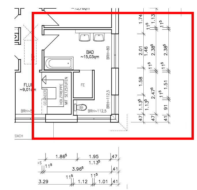

You mentioned that you had designed a proposal.
  • Would you be so kind as to quickly share it here again so I can take a look?
  • For everyone else: Do you have any ideas for an improved layout of the sanitary fixtures? The size of the shower can, for example, be adjusted.
Thank you very much.
Berlinho2
2D bathroom floor plan with bathtub, sink, toilet, and hallway

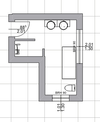

Ibdk1424 Jun 2022 10:43
Maybe like this? The dimensions aren’t quite right. The shower and door will probably be too tight. Or place the bathtub and toilet along the left wall of the plan?

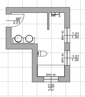

Ibdk1424 Jun 2022 10:55
Damn, I can’t edit my post anymore. I have another idea, but I’m not really happy with it either. I’ll leave it to those who know more about this :-)
Compact bathroom layout with sink, toilet, and bathing area in the floor plan

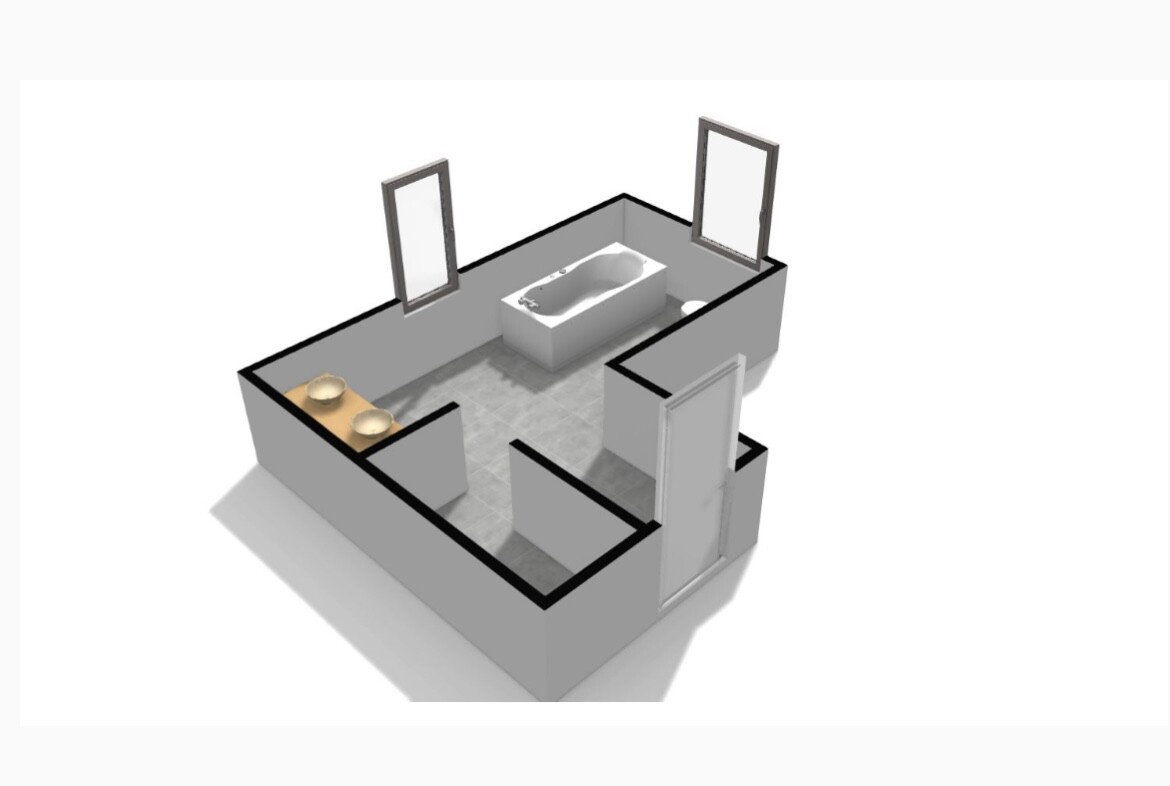

2D doesn’t work… I’ve taken screenshots now. The toilet is placed in the corner. @kbt09 suggested rotating it. I positioned it that way so you can look out the window. The window locations are carried over from the ground floor for aesthetic reasons, but you can of course place the window by the washbasin as you planned.
Washbasin by natural light, fairly well usable space, fairly large central living area, bathtub in the quiet zone without a window. … 🙂
3D floor plan of a bathroom: central bathtub, double washbasin on the left, door on the right.
3D floor plan of a bathroom with bathtub, toilet, and double washbasin

I completely agree that the bathtub needs to go! I also like the larger living area.
If you add a nice glass partition at the shower, you a) save some width and b) reduce the "tunnel vision" effect when walking into the bathroom significantly. Additionally, there’s no risk of accidentally bumping into someone when opening the door.
