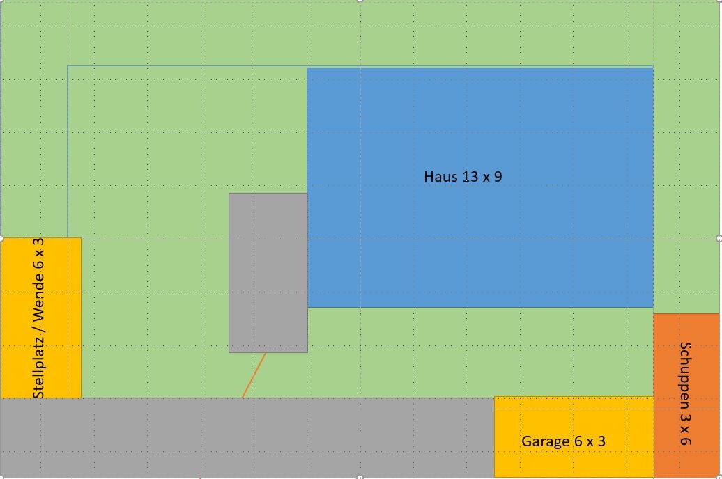

thanks a lot for your reply.
I’m not a fan of patching things up either. But building the garage in the southwest right next to the driveway doesn’t seem ideal either, since that’s the best sunny spot. That’s why I was thinking to place it “as far to the right as possible.”
Do you mean something like version V5 in the attachment?

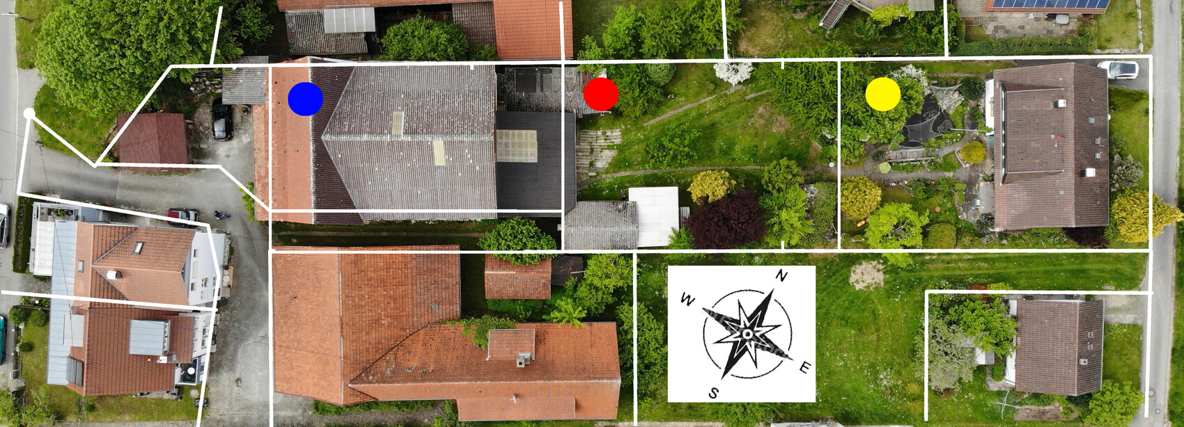

I’ve also included the original aerial photo. You can see the neighboring properties there as well.
The driveway to the red property doesn’t belong to the red one but to the yard on the far left. (This is still shown incorrectly in the picture.) This will be regulated by a right of way agreement. It’s all within the family.
The yellow and blue properties also belong to us. The blue barn will be demolished soon.

Garden floor plan: blue house 13x9, garage 6x3, parking space 6x3, shed 3x6 on green lawn.
Aerial view of a residential area with white boundary lines, three colored dots (blue, red, yellow) and a compass rose.

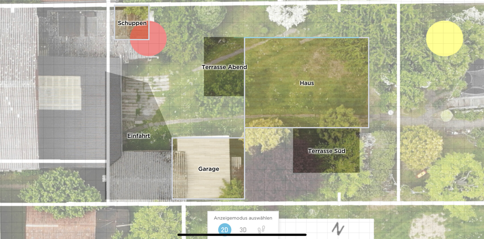

I would do it like this:
Aerial view of a property with house, evening terrace, south terrace, garage, shed and driveway
The driveway should be shaped so that you can turn around.
You probably don’t need any privacy screening for the nice driveway paving in a dead-end street. There is no one else there.
You could basically let the terrace flow into the driveway, for example with some loose shrub planting. With the double garage you already have two parking spaces.
The shed is currently only marked as 3 x 3 meters (10 x 10 feet).
P.S. A shame about the beautiful trees 🙁
