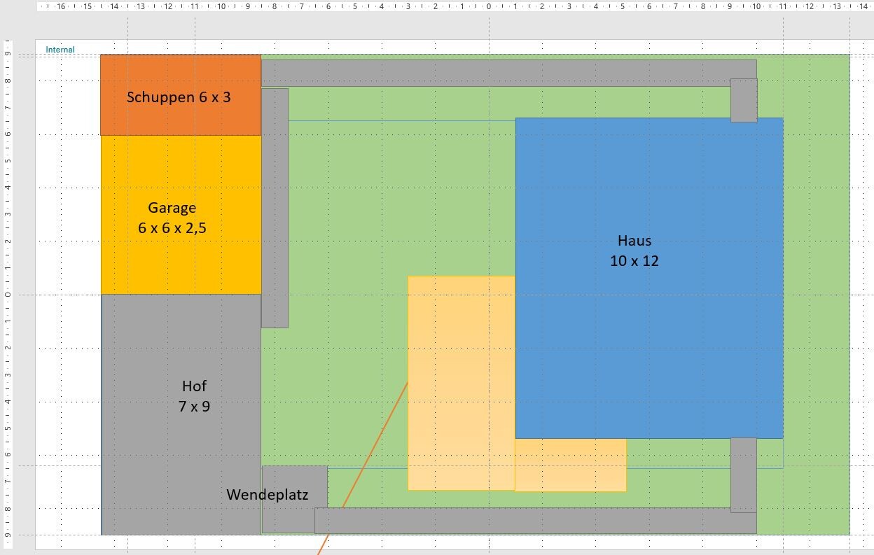

Samsonite2 Jun 2022 21:58So, we have now received the approval for additional development, and according to the district office, there should currently be no issues with the construction. That obviously makes me very happy.
Now it's time for further planning, and I have a question right away:
Do you think I can reverse out and turn around with the vehicle shown at the bottom? The vehicle is 5.20 meters (17 feet) long, and the width of the yard (from the lower boundary to the house wall) is currently planned to be 7 meters (23 feet). Somehow, it seems to me that it could work 🙂
Samsonite3 Jun 2022 07:47Whether it will turn out like that in the end – no idea.
I'm simply lacking options. I have to designate 2 parking spaces and cannot reverse 70 meters (230 feet). So, I need to be able to turn around somewhere.
I don’t find it very appealing either…

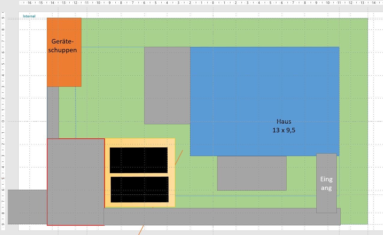

Samsonite3 Jun 2022 09:27Yes, I tried the proposal again. Do you know how large the "yard" needs to be? So that it gets approved or also so that it’s easy to access?
It is marked in red in the picture with version 2.
Otherwise, there is version 1 with the entrance at the top or bottom. Somehow it’s quite charming as well.
But it’s really not easy... and it’s quite exhausting 🙂

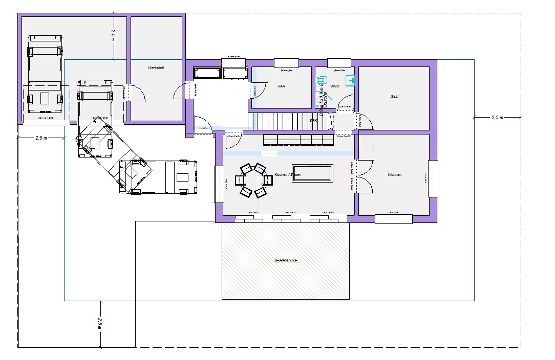

Samsonite schrieb:
I have no idea if it will turn out like that in the end.
I just lack options. I need to designate 2 parking spaces and can’t reverse 70 meters (230 feet). So I have to be able to turn somewhere.
I don’t really like it either… Yes, you are not entirely wrong. If you want and need to turn around, it takes quite a bit of space.
I was thinking more along these lines:
Oops, forgot the window in the guest room.
