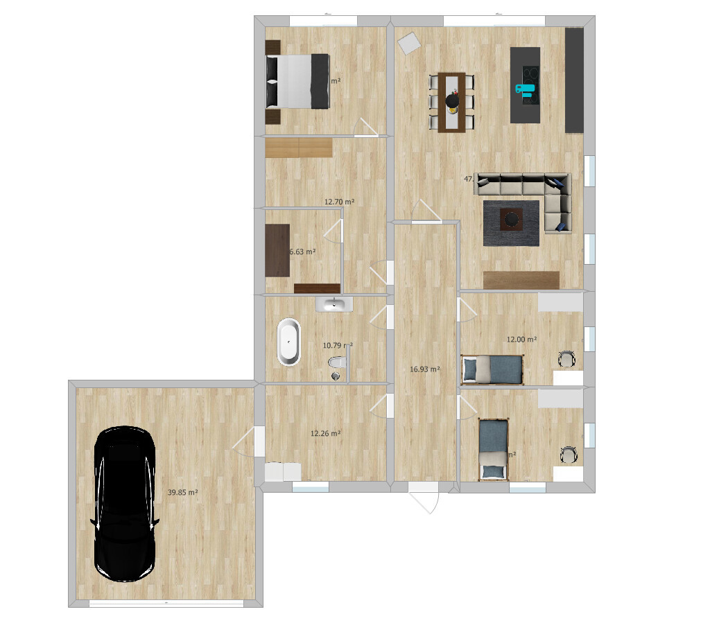

we are planning to start construction in June/July. Our architect is currently working on the drawings, so I wanted to join here and ask for your ideas or suggestions to improve my floor plan. At the moment, there are no dimensions included because it's purely about the room layout right now. Does anyone have an idea how to reduce the hallway from 16/17m² (172/183 sq ft) and somehow gain a bit more living space for one of the rooms? What else could or should be optimized in the floor plan? As soon as the drawings are ready, I will upload everything here and keep you updated throughout the build. A lot of the work will be done by ourselves.

Floor plan of a house: living room with dining area, kitchen, bedroom, bathroom, hallway, garage, terrace.

I have created a version without the covered terrace. We don’t need a dedicated storage room for food. For the cloakroom, we thought that since the hallway is quite narrow and long, we could place a wardrobe there for coats and jackets. I also slightly enlarged the utility room, so there should be some space for a vacuum cleaner and laundry. Additionally, I separated the walk-in closet and the office again. Personally, I don’t mind using the walk-in closet as a passageway to the bedroom. However, I have omitted the guest toilet this time, since we rarely have visitors and if we do, it’s usually my wife’s mother who stays for a few days and uses the main bathroom anyway. I’m not sure if it really makes sense to do without the guest toilet.

Where do you plan to place a coat rack in the hallway without shoes, bags, and other items getting in the way? The hallway offers little space. Your layout of the master bedroom also takes up a lot of square meters. Add up the total square meters of the walking areas.
Why don’t you rotate the bungalow by 90%?
Why do you want to leave such a large area under the roof unused?
A guest toilet is definitely not necessary. I wouldn’t want to do without it. Do you want every guest, friend of your children, or tutor to use your main bathroom? The one where personal care items are stored or where a bra might accidentally be left behind?

I wasn’t sure how to separate this sensibly from the bedroom without making the hallway even longer. Attached are the street and orientation plans.
Well… normally house design is more than just a series of rooms put together. Unfortunately, that’s all I see here.

I agree! @erwin93 ... 27 years old? ... You’re building a family home now. When you’re 70, that will be 43 years from now. Do you want a central, square hallway that the bedrooms and living room open onto, or not even that? And you won’t want a garden anymore at that point either.
What I’m saying is: you don’t even know yet what the future holds and what wishes you’ll have… the house is for a family now and therefore should be planned accordingly.

In my opinion, a 1.5-story house is also something your architect should recommend to you.
It won't be more expensive either.
