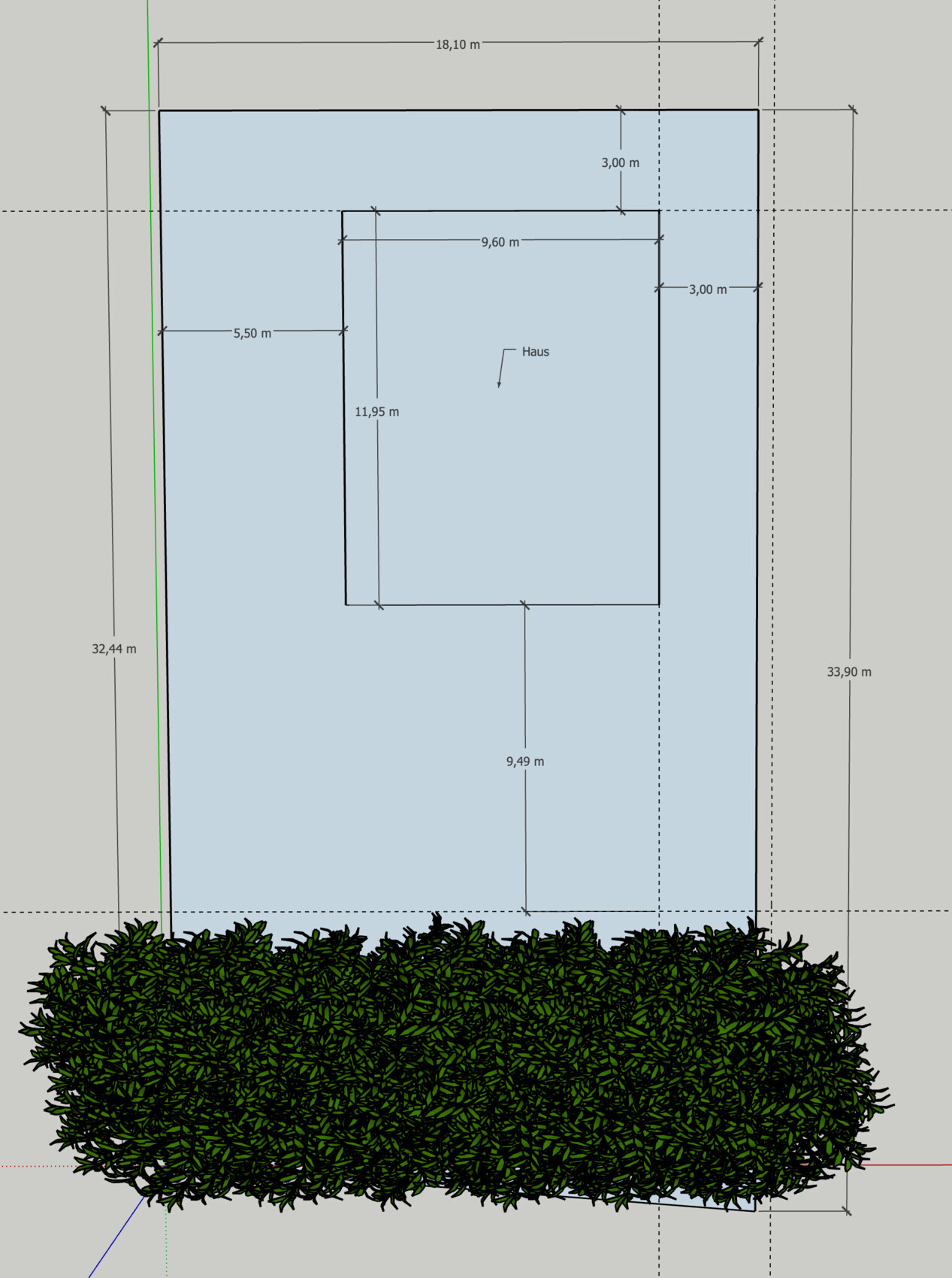

I more or less stumbled upon a plot of land after someone let their reservation expire.
The plot is about 606 square meters (6,521 square feet), according to my "measurement" approximately 18.10 meters by 33.50 meters (60 feet by 110 feet), not officially surveyed yet, and now I’m wondering exactly what I can do with it.

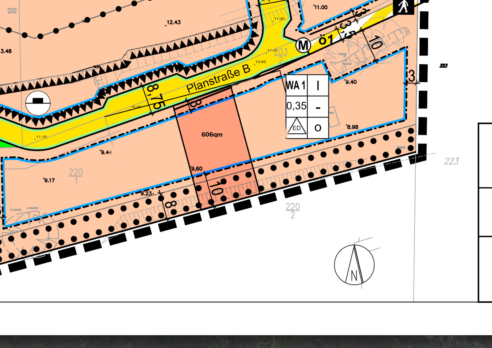

The development plan sets out the following for "my plot":

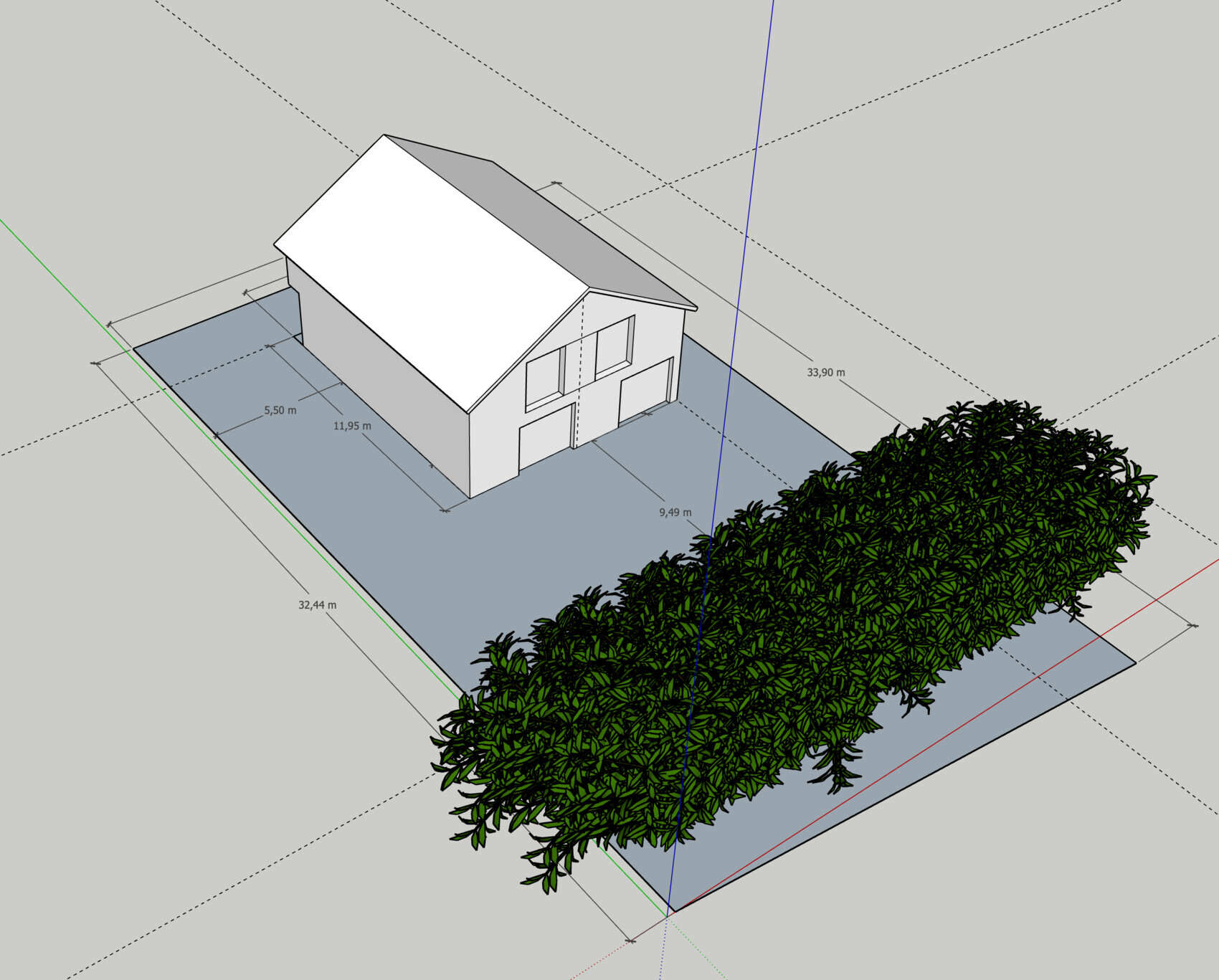

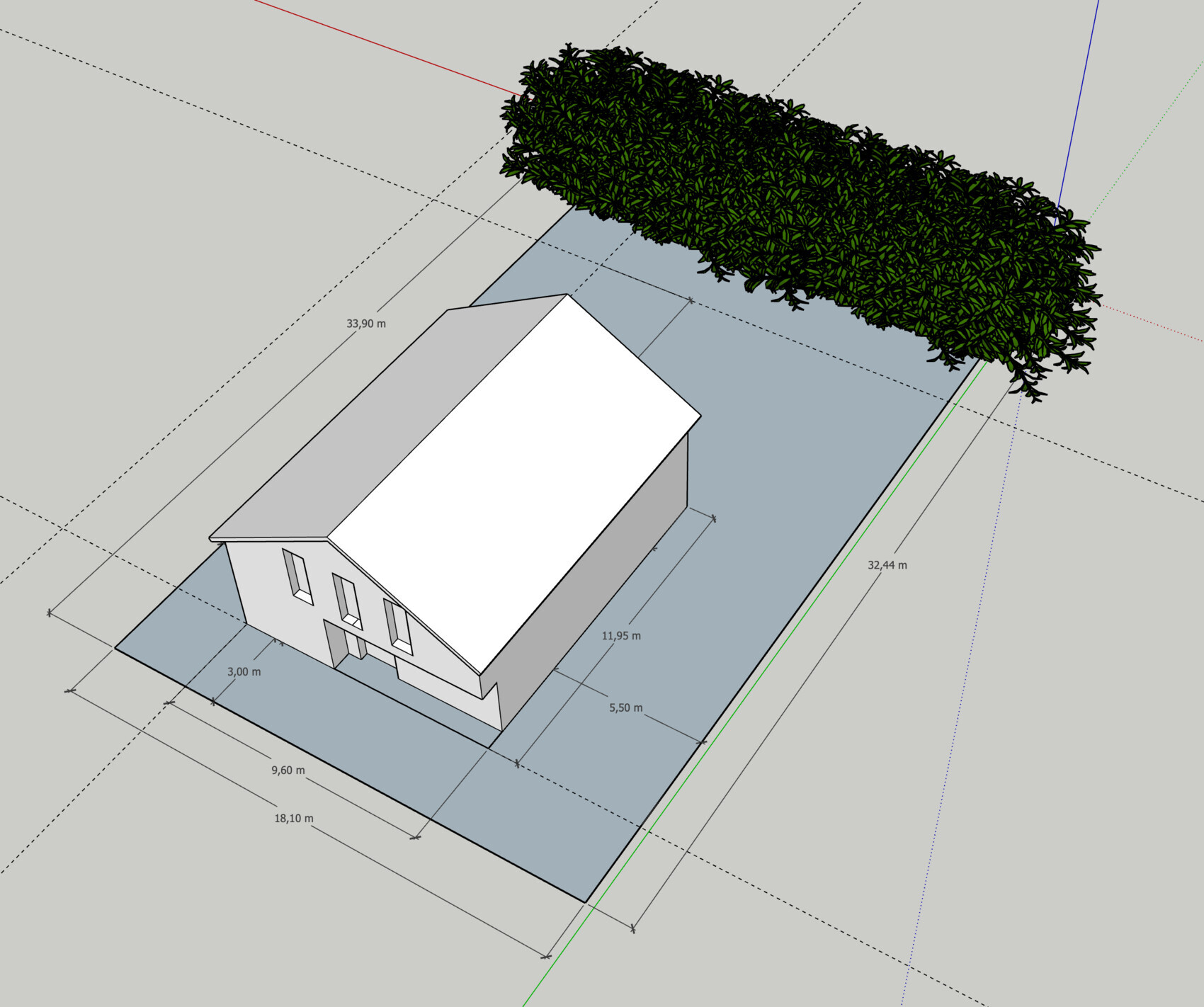

Here I have placed an example house measuring 9.60 meters by 11.95 meters (31.5 feet by 39 feet), which I like based on my initial review (Viebrockhaus Edition 600).
Next to the house, in the 5.50-meter (18 feet) wide space there would be a carport – is that enough space for two parking spots? I would prefer not to make the house narrower just to accommodate vehicles... but then there’s hardly any room left for fencing?!
The terrace and garden at the back are, of course, limited by the tall trees – but that’s a compromise I’ll have to accept.
I’ve never built a house in my life before... so this is my first time dealing with this topic in detail. What would you do in this situation? Make the house a bit smaller?
If you need more information, just ask – as I said, I’m a beginner and eager to learn 🙂
My wishes are:
- Starting from 160 square meters (1,722 square feet) upwards
- I’m currently thinking about a basement and budget around $100k extra for it
- I don’t like long corridors
Once the plot situation is reasonably clear, I’d like to hear your advice on floor plans – that will surely be a more extensive topic.
- 0.35 floor area ratio
- Single-story buildings only
- Maximum building height 10 meters (33 feet)
- Eave height max 4.50 meters (15 feet)
- One driveway with max width of 4 meters (13 feet)
- Two parking spaces are mandatory
- Roof pitch between 15° and 51°
- Roofs of garages etc. may differ in shape
- Garages, carports, and ancillary buildings as defined by §14 (1) of the building use ordinance, which are buildings, must not exceed the street-side building boundaries of the access roads.
- Dormers and roof recesses: the total length of dormers or roof recesses per roof side may not exceed 50% of the total length of that roof side.
- Standard distance to property boundary is 3 meters (10 feet)
- In the southern area, there is an 8-meter (26 feet) deep strip across the full width of the plot (approx. 18 meters (60 feet)) where trees and shrubs must be preserved. This area is quite densely vegetated and reaches heights up to 10 meters (33 feet) – I’ve tried to visualize this below
- In the middle of this vegetation is a downward slope... the building boundary to this strip was reduced from the normal 3 meters to 2 meters (7 feet) so the plots aren’t too restricted.

I find 5.5 m (18 feet) narrow for a carport. However, I wouldn’t limit the house when it comes to parking spaces.

5.50 m (18 ft) would of course be sufficient. Personally, I prefer more.
For the parking spaces, I would bend the ground floor sideways, like the E600 does at the front, for example.

In my opinion, the house doesn’t fit the plot: it’s too wide and has an unappealingly long corridor, which you don’t like anyway. You don’t have to plan a utility room (or storage space) on the nice west side.

There are still two large e-bikes (shed behind carport?). Then the house will have to be narrower, or precise parking will be necessary, or the shed passageway must be aligned exactly with the central alley. Overall, the package of requirements still seems to me to be a candidate for significant cost-cutting.
