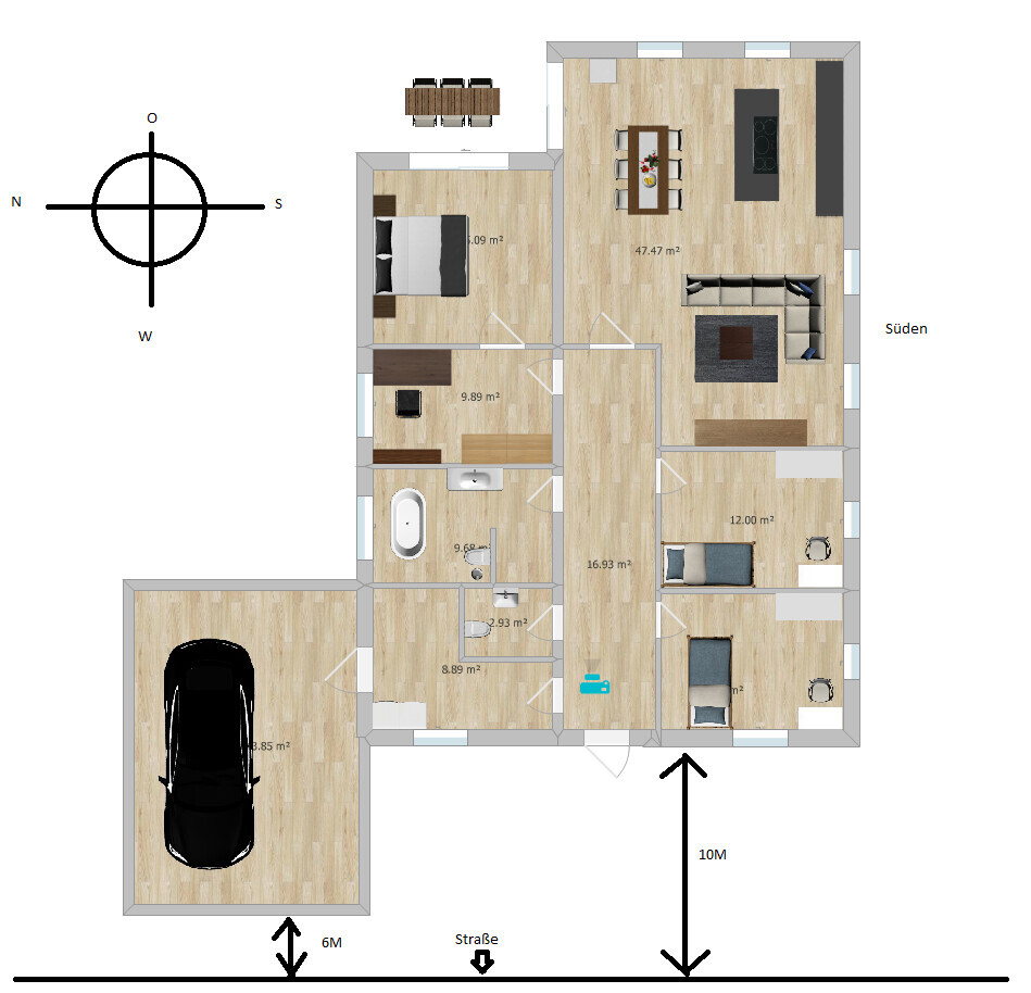

we are planning to start construction in June/July. Our architect is currently working on the drawings, so I wanted to join here and ask for your ideas or suggestions to improve my floor plan. At the moment, there are no dimensions included because it's purely about the room layout right now. Does anyone have an idea how to reduce the hallway from 16/17m² (172/183 sq ft) and somehow gain a bit more living space for one of the rooms? What else could or should be optimized in the floor plan? As soon as the drawings are ready, I will upload everything here and keep you updated throughout the build. A lot of the work will be done by ourselves.

Where is north, and what is the plot like?
With the long layout and the rather poor room arrangement, questions about the plot, access, orientation, etc., naturally arise.
It somewhat reminds me of @Steffi33. But Steffi enjoys the long hallway 🙂
I find several aspects of the design quite unfortunate, starting with the cold storage room and its two doors, whose shape and size do not suit a passageway. Also, the combination of office/dressing room with the layout, and planning a room with double functions as a passageway.
Again: you are using tiny rooms like the cold storage as a utility room, and the office as a dressing room, both doubled up, and still want to use them as passageways to important rooms. That cannot work satisfactorily in the long term.
Then I see the kitchen at the far end, quite far from the mop sink or electrical appliance in a storage room, which actually does not really exist.
Please give some explanations about what you had in mind here. It can’t be due to a lack of budget. I would allow the house a few more square meters, and a plan where ancillary rooms are consciously and sensibly integrated, for example in a converted attic.
That’s why I’m here. I’m not experienced with the following topics regarding room layout, as we live in a very tight space. The issue with the office/dressing room is that I wasn’t sure how to separate them from the bedroom in a practical way without making the hallway even longer. Here’s an attachment showing the street and orientation.
We were reluctant to convert the attic because we want everything to be age-friendly on one floor. The covered terrace is planned for bad weather. However, the terrace should also be extended along the entire (east) side of the house so that we don’t have to sit in the shade all summer. Maybe we could skip the covered terrace and somehow use that space for the house instead? Later, we could just put up a kind of pavilion behind the house, which would also give us a covered terrace.
When people talk about "for old age," it’s always easy to say. What condition do you think you will be in when you say "for old age"?
The bungalow, as planned, is not suitable once anyone has more than just minor difficulties with stairs.
You now need a home office, children’s rooms, and more storage space. Why leave the attic unused? You are missing a cloakroom, storage room, HVAC space, and laundry area is getting tight. The home office with a wardrobe serving as a walk-through room.
Why don’t you include the attic in your plans? A spacious master suite can still remain downstairs, so later on you effectively have a bungalow.
Always draw all existing and desired furniture to scale. When drawing the table, also consider the space needed for occupied chairs. What doesn’t work on graph paper won’t work in reality either. Suddenly, the washing machine ends up in the bathroom because the HVAC space needed a few centimeters (inches) more.
