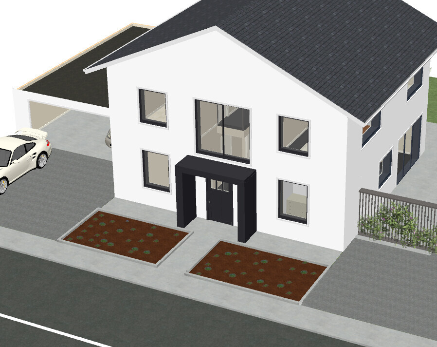

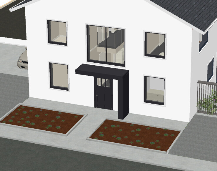

After five weeks, the ceiling contractor finally realized that the canopy is not feasible because there is no concrete ceiling at all behind it in the gallery. Accordingly, only a porch roof with two walls on the right and left sides would be possible. However, we are not very happy with this solution. Does anyone have a better idea?

face264 Aug 2020 18:53
Yes, order a precast concrete element from the concrete plant. Exposed concrete. An inverted U-shape. 5cm (2 inches) distance from the masonry. It stands on its own and at the same time forms a platform.

Joedreck
4 Aug 2020 18:58
Should this be attached to the ceiling below?
hegi___
4 Aug 2020 19:03
face26 schrieb:
Yes, order a precast element from the concrete plant. Exposed concrete. An inverted U shape. 5 cm (2 inches) gap from the masonry. It stands on its own and also functions as a platform.
The U shape can also be built with masonry and concrete. That costs us about 1100 € (approximately 1300 USD). But we don’t like the U shape. We only wanted an L shape.
Joedreck schrieb:
Should this be attached to the intermediate ceiling as well?
It doesn’t really matter, but the structural engineer said it’s not possible otherwise, because there is no opposing support.
